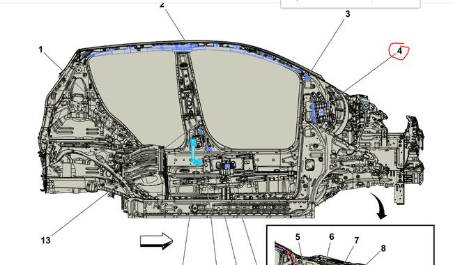

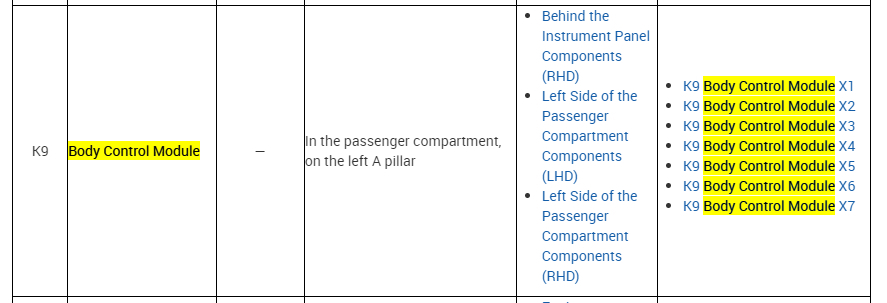

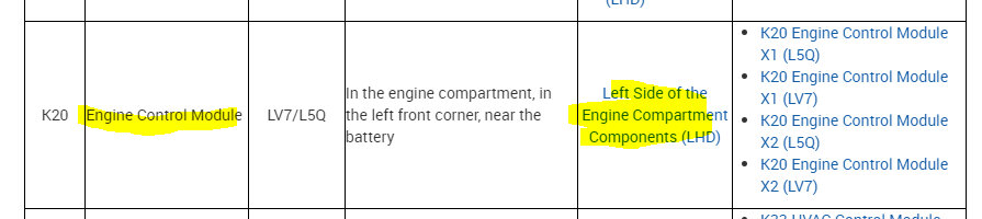

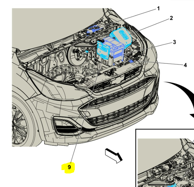

One is in the vehicle and the other is under the hood. The body control module is located behind the left kick panel (A-pillar). See pics 1 and 2. The engine control module is under the hood near the battery. See pics 3 and 4.

I have no idea what I'm looking at in picture 2, is that the side of the car?

No problem. That is the driver's side of the interior of the vehicle. I agree the pic isn't too clear. That's what we get in the manuals.
