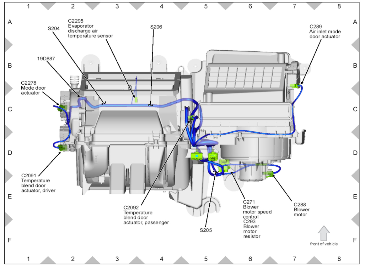

Can you please tell me where the A/C heater blend door actuator is on my car? It is the SE model? Would you also have an illustration of the area? I would really appreciate it. Single zone. Thanks,

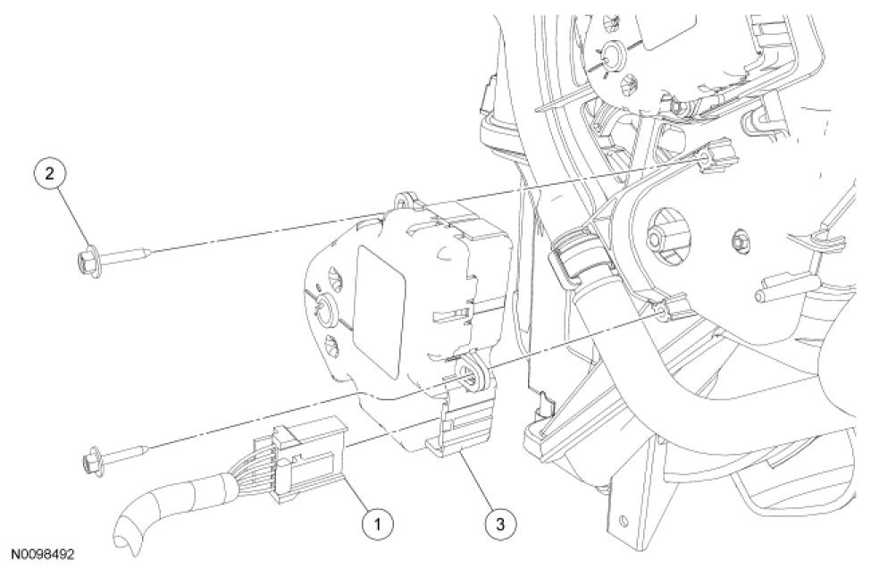

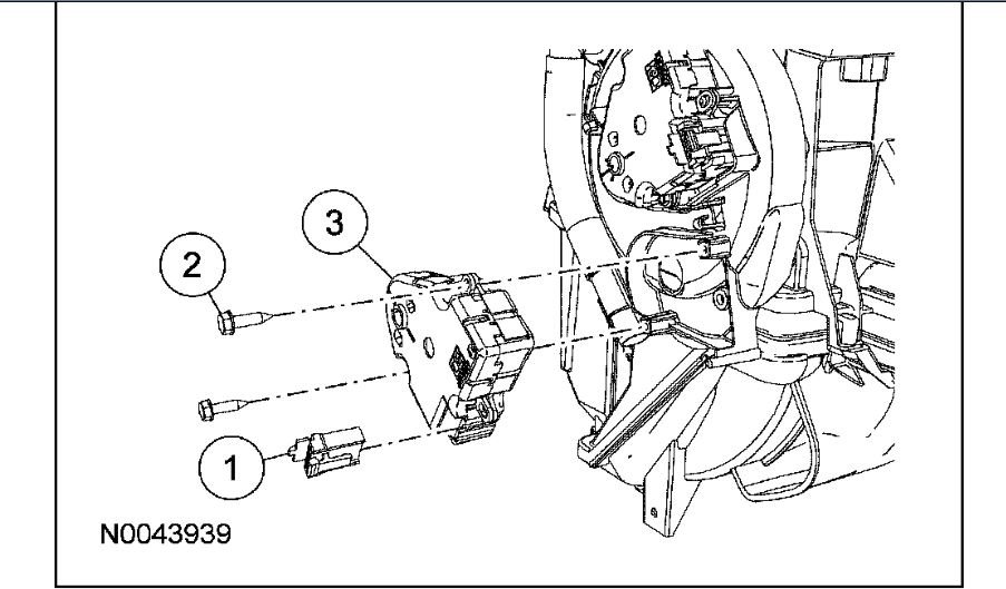

located left hand side of heater box here is a guide to help you see what you are in for when doing the job with the location of the blend door actuators below.
Jun 17, 2017 at 7:13 AM
SILOKOJAK
Hello, thank you for the information. Is the location of the heater box near the radio? If so, does it show what and how to remove the parts needed to get to this A/C heater blend door actuator?
Jun 17, 2017 at 8:06 AM
You to start removing lower dash covers and then use a flashlight to locate the actuator. Some spot are a little tight use 1/4 drive tools to remove the actuators.

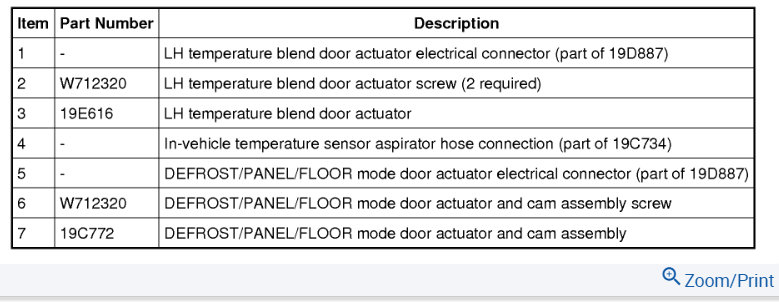

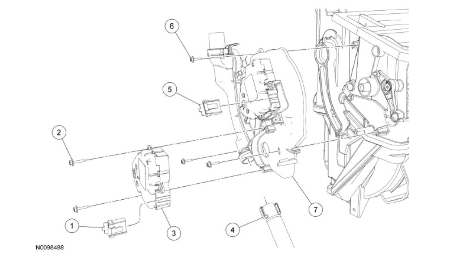

Here are the instructions and diagrams below:
Removal and Installation
1. Remove the instrument panel. For additional information, refer to Instrument Cluster / Carrier &/or Interior Moulding / Trim.
2. Disconnect the LH temperature blend door actuator electrical connector.
3. Remove the 2 LH temperature blend door actuator screws.
4. Remove the LH temperature blend door actuator.
5. Disconnect the in-vehicle temperature sensor aspirator hose connection.
6. Disconnect the DEFROST/PANEL/FLOOR mode door actuator electrical connector.
7. Remove the 3 DEFROST/PANEL/FLOOR mode door actuator and cam assembly screws.
8. Remove the DEFROST/PANEL/FLOOR mode door actuator and cam assembly.
9. To install, reverse the removal procedure.
10. NOTE: The purpose of the module actuator position calibration is to allow the HVAC module to reinitialize and calibrate the actuator stop points. To carry out calibration, carry out the following steps.
Remove the Smart Junction Box (SJB) fuse 15 for at least one minute. See: Power and Ground Distribution > Electrical > Power Distribution Diagrams
11. NOTE: When the ignition switch is switched to the ON position, the HVAC module will initialize and calibrate the actuators. Calibration of the actuators will take approximately 30 seconds.
Reinstall SJB fuse 15. Turn the ignition switch to the ON position and wait 30 seconds before verifying correct DEFROST/PANEL/FLOOR operation.
Check out the diagrams (below). Please let us know what you find.

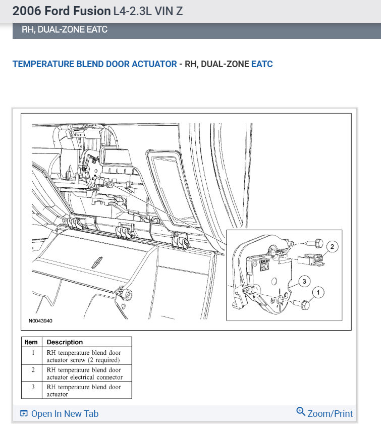

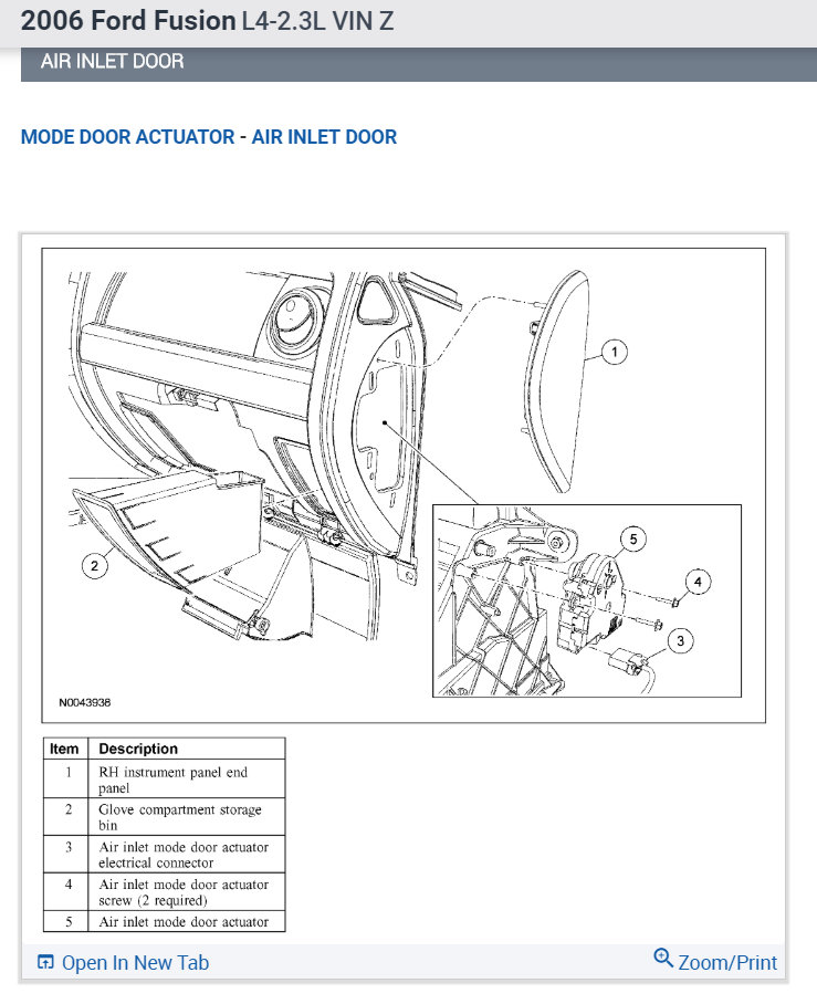

There is only hot air coming out of the two passenger side dash vents when the heat is on. Cold air coming out of the driver's side dash vents and floor vents. No air coming out of the defrost vents. This doesn't change no matter what heat setting is selected. (defrost/dash vents/floor). I think it is the blend door actuator, so I went to the parts store and they told me that there are three different ones for my car. (Left, right and main). I was hoping you could tell which one I need.
Oct 14, 2020 at 12:51 PM (Merged)
Hi and thanks for using CarPros.
The air flow directions is controlled by a mode door actuator. Here are the directions for replacement.
Mode Door Actuator - Defrost/Panel/Floor Door
Picture 1

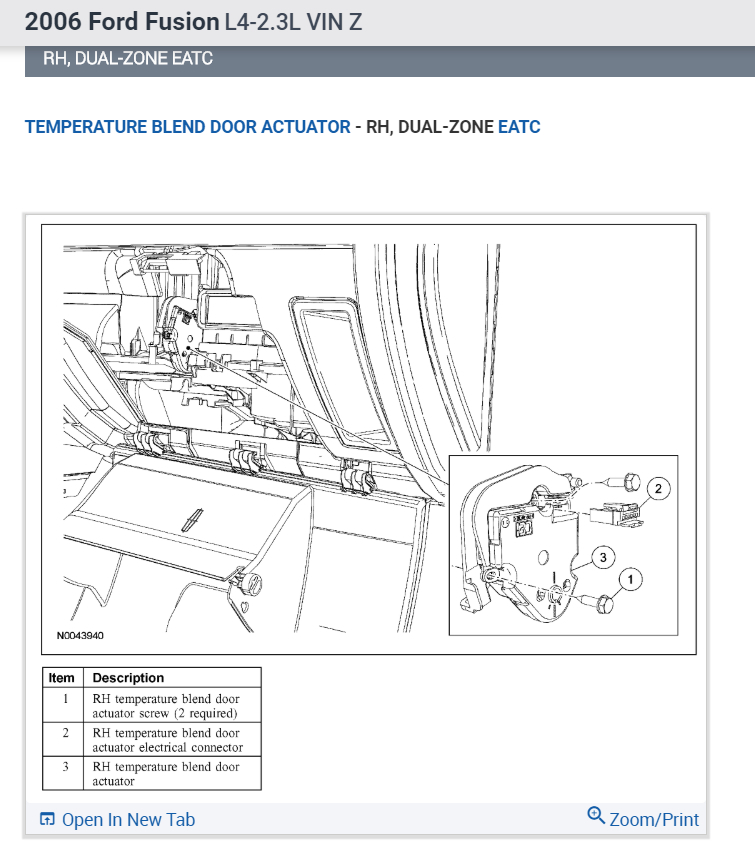

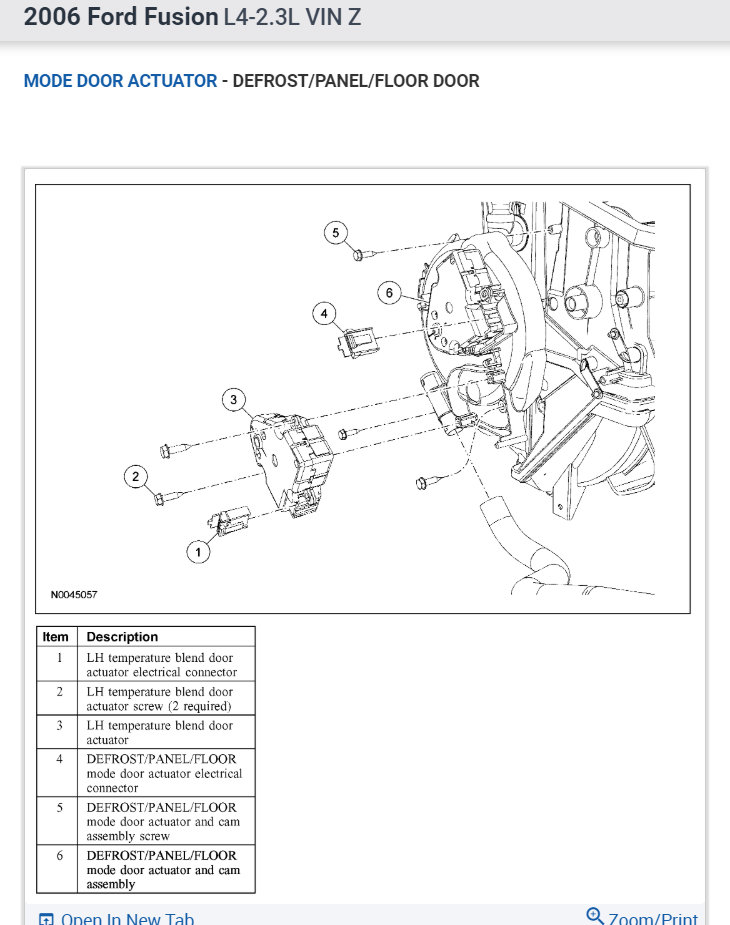

As far as no heat from the left side, that is a blend air door actuator. Here are the directions for the left side actuator replacement.
First, here is the general procedure.
Here are the specific directions.
See pic 2
NOTE: The LH temperature blend door actuator can be accessed from below the LH side of the instrument panel to the right of the accelerator pedal.
1. Disconnect the LH temperature blend door actuator.
2. Remove the 2 LH temperature blend door actuator screws.
3. Remove the LH temperature blend door actuator.
4. To install, reverse the removal procedure.
5. NOTE: The purpose of the module actuator position calibration is to allow the HVAC module to reinitialize and calibrate the actuator stop points. To carry out calibration, carry out the following steps.
6. NOTE: When the ignition switch is switched to the ON position, the HVAC module will initialize and calibrate the actuators. Calibration of the actuators will take approximately 30 seconds.

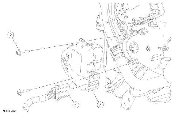

Car listed above is the SE Model.Can you please tell me where the A/C heater blend door actuator is on my car? Would you also have an illustration of the area? I would really appreciate it. Single zone. Thanks

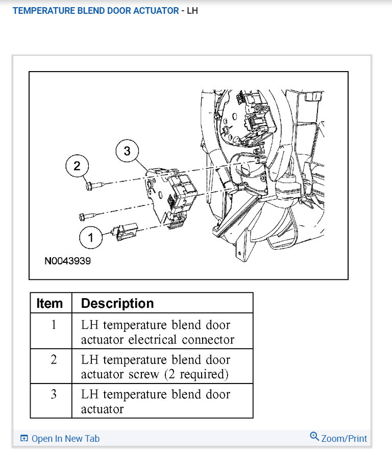

Good morning,
I attached the procedure and the picture of the location for you to view.
NOTE: The LH temperature blend door actuator can be accessed from below the LH side of the instrument panel.

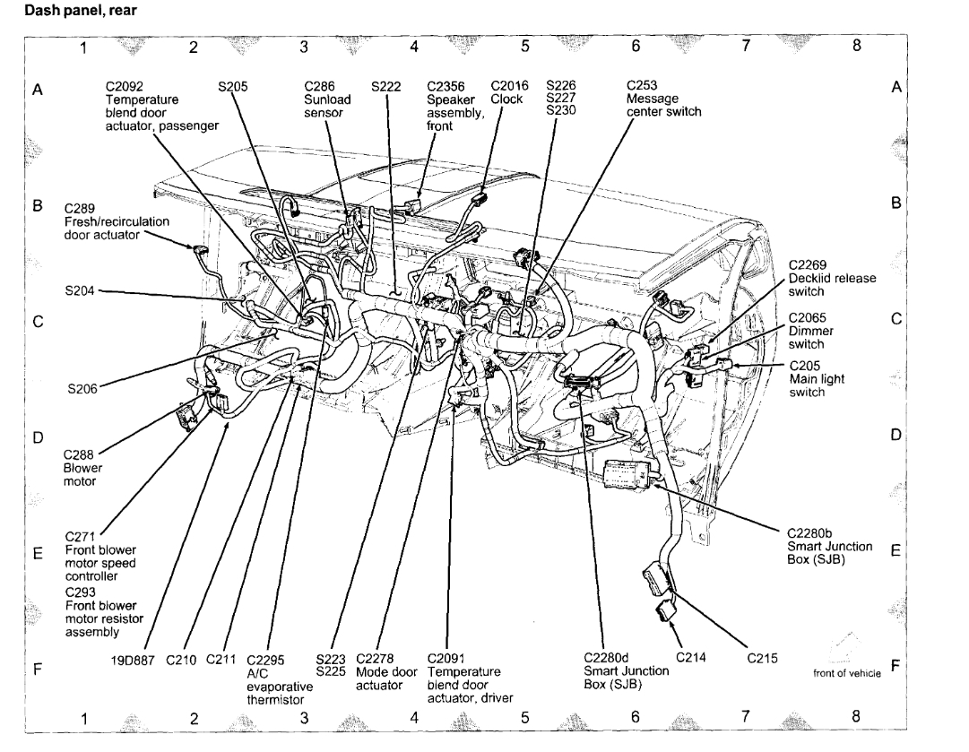

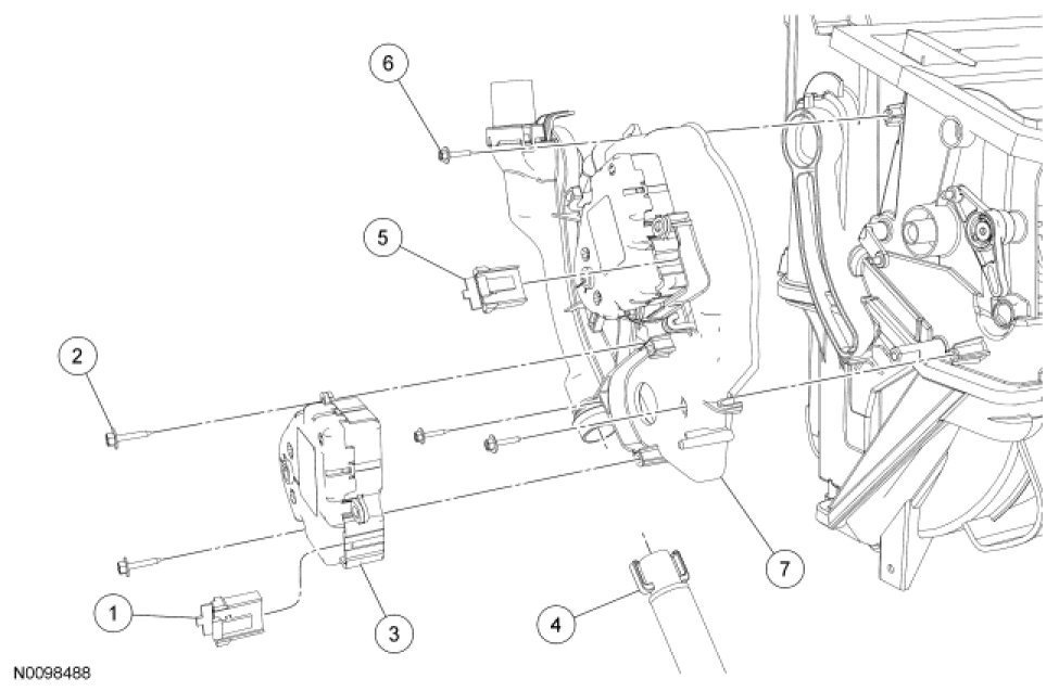

A/C not blowing out of front center and sides only out passenger bottom and top vent Where is the AC/heater blend actuator main unit air inlet located?
I have this guide that will walk you through the repair with the blend door locations for your car in the diagrams below.
