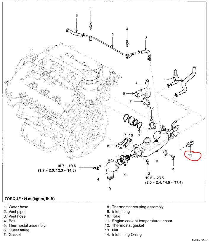

overheat temperature of engine.
Aug 28, 2021 at 7:12 PM
SQM
CERTIFIED EXPERT
6,383 POSTS
The coolant temperature sensor if located on the back of the thermostat housing on the right hand side of the engine (as you are facing the engine). See diagram below.
