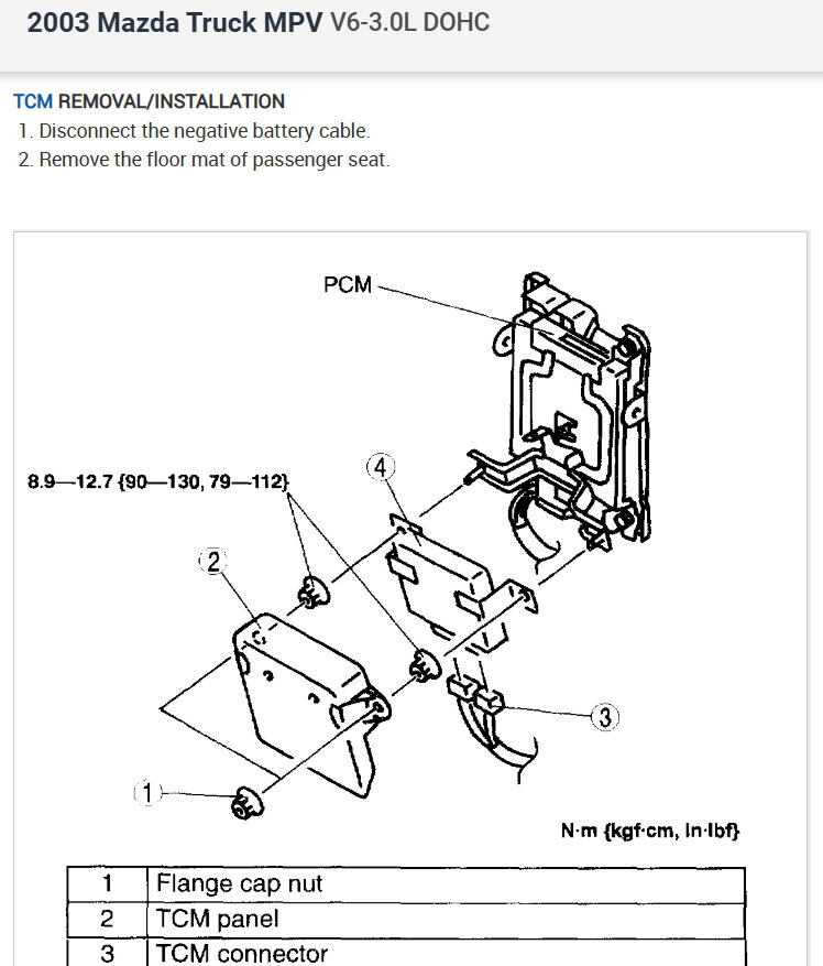

I need to know where the TCM is located on my vehicle listed above. A diagram would be most helpful too if possible.
Jan 1, 2025 at 11:13 AM

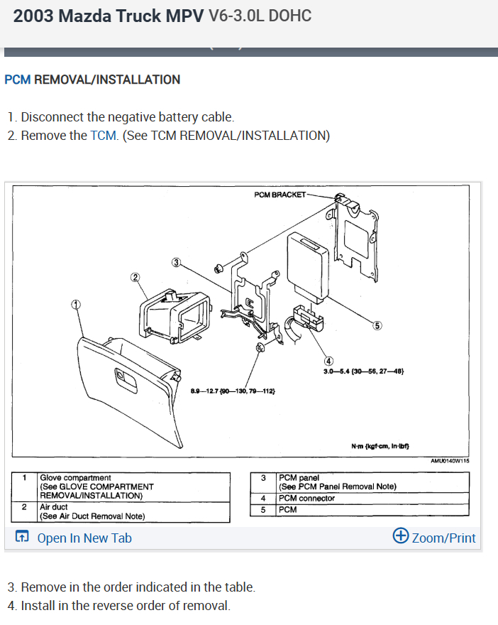

the transmission control module is below the right side of the dash. Which look like it is the PCM, there are calling it the same thing, here is the locations. Check out the images (below). Let us know if you need anything else.
