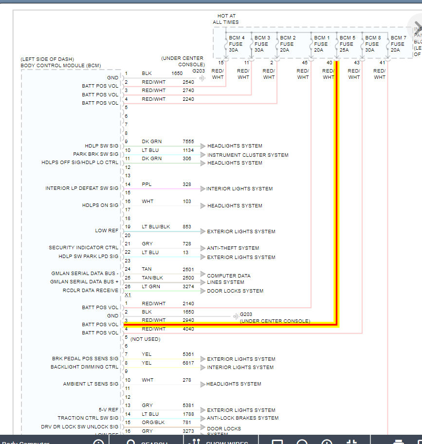

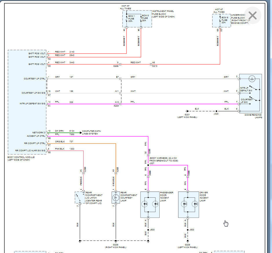

I assume you are talking about the BCM fuse 5? If so, we need to address that separately because that not related to the TCM. That is an interior lighting system. Let me know if that is the correct fuse.

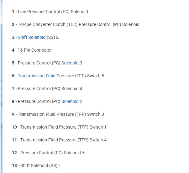

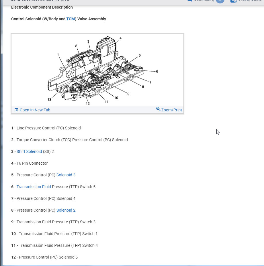

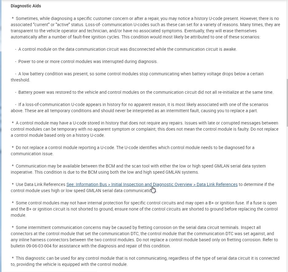

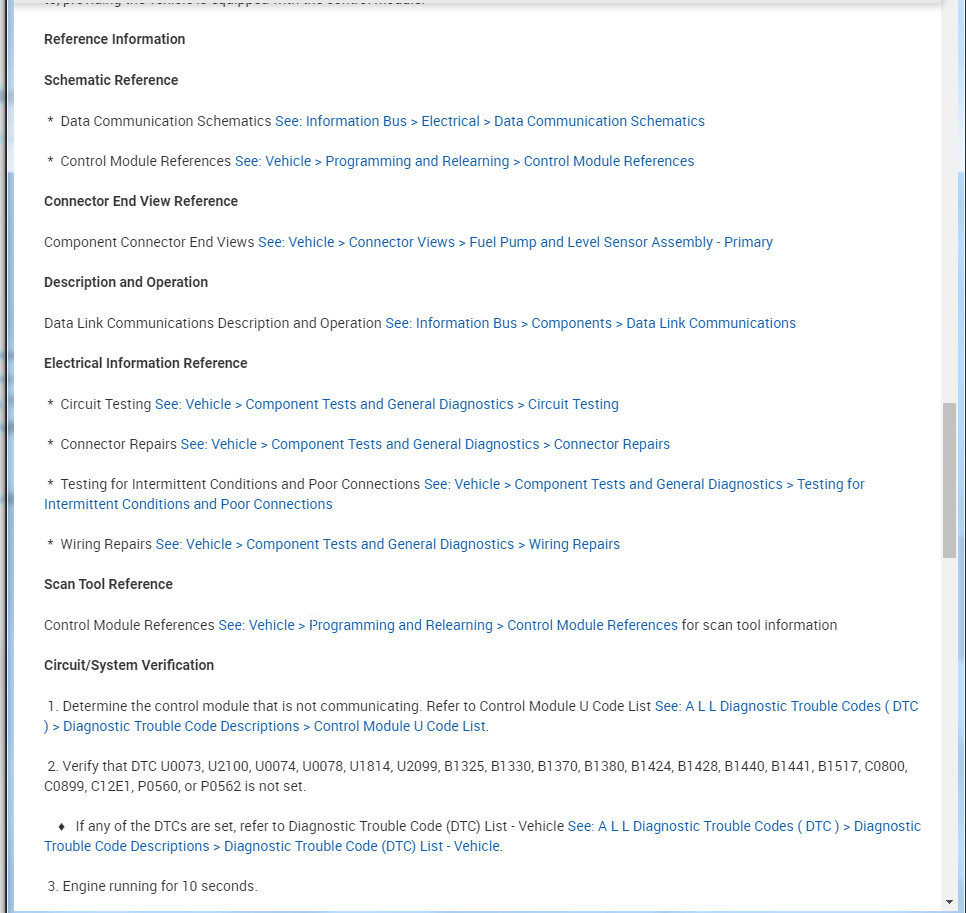

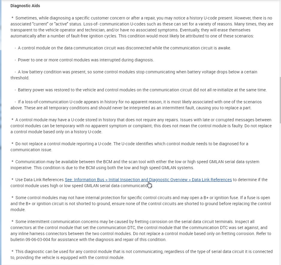

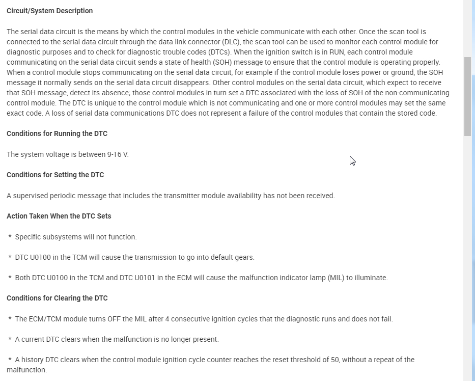

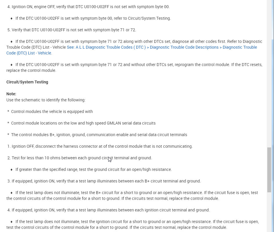

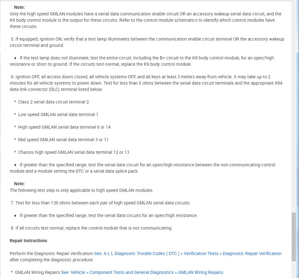

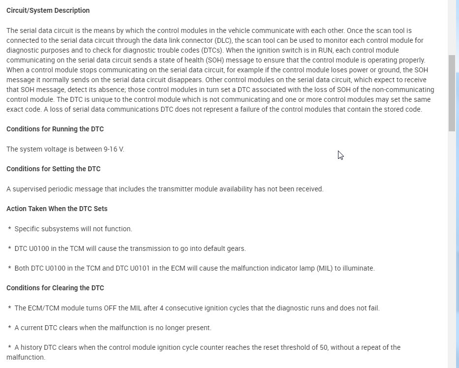

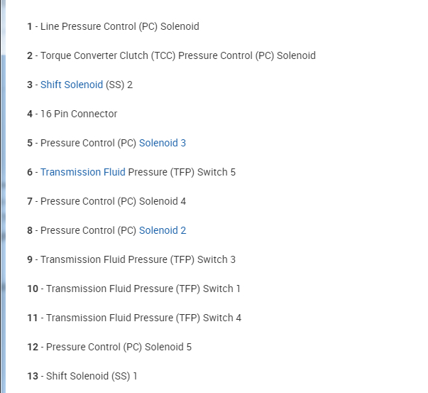

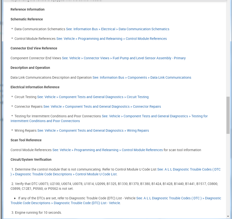

As for the code, we need to run through this testing that is attached. The TCM is part of the valve body inside the transmission pan.
Let me know what you find with this and what other info you need.

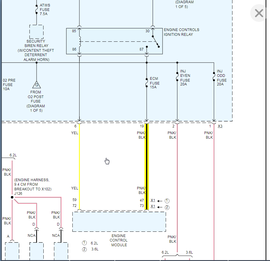

Okay. Thanks for that info. Can you look at that wiring diagram and tell me if that is the fuse that is blowing? Maybe get a picture of the location if you want to. The reason I ask is the fuse I pointed as Fuse 5 is a 25 Amp fuse not a 15 so that may explain why it is blowing.
Apr 9, 2020 at 4:37 PM

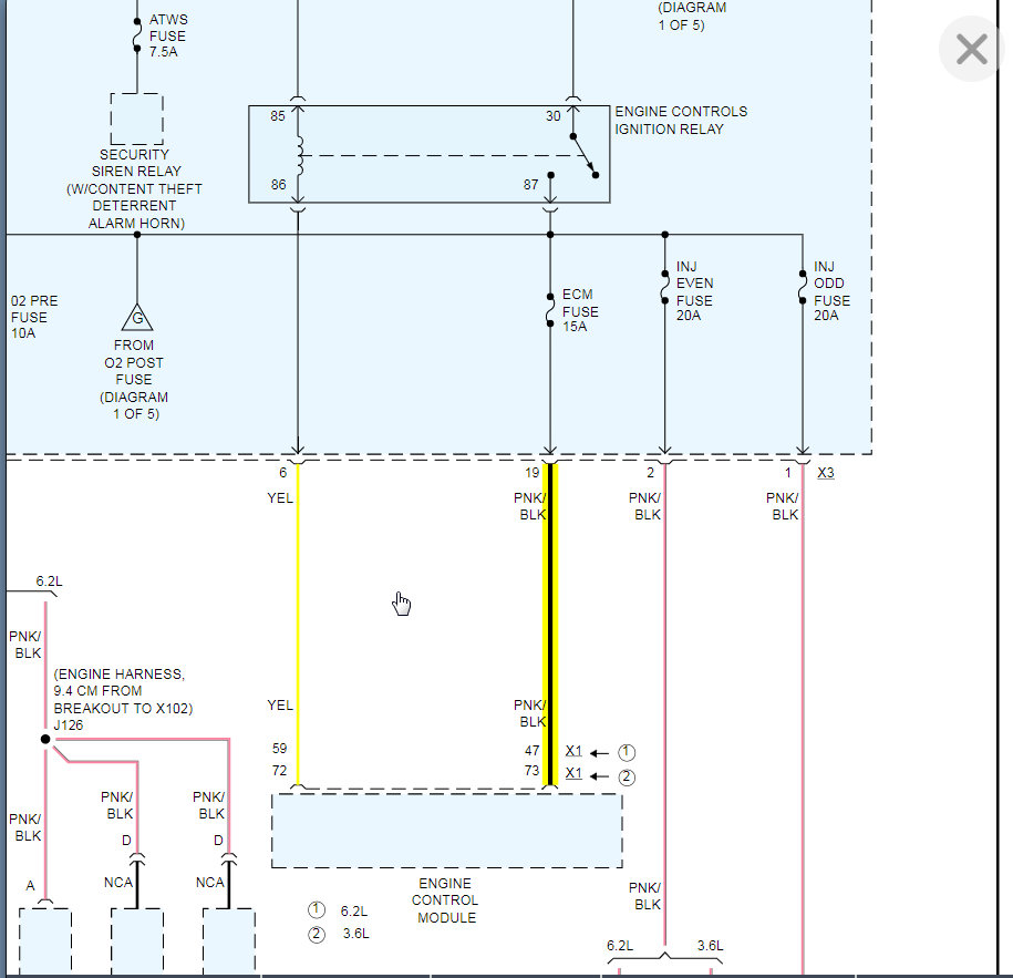

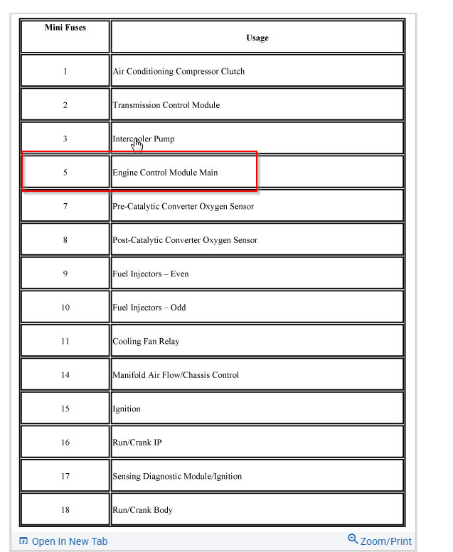

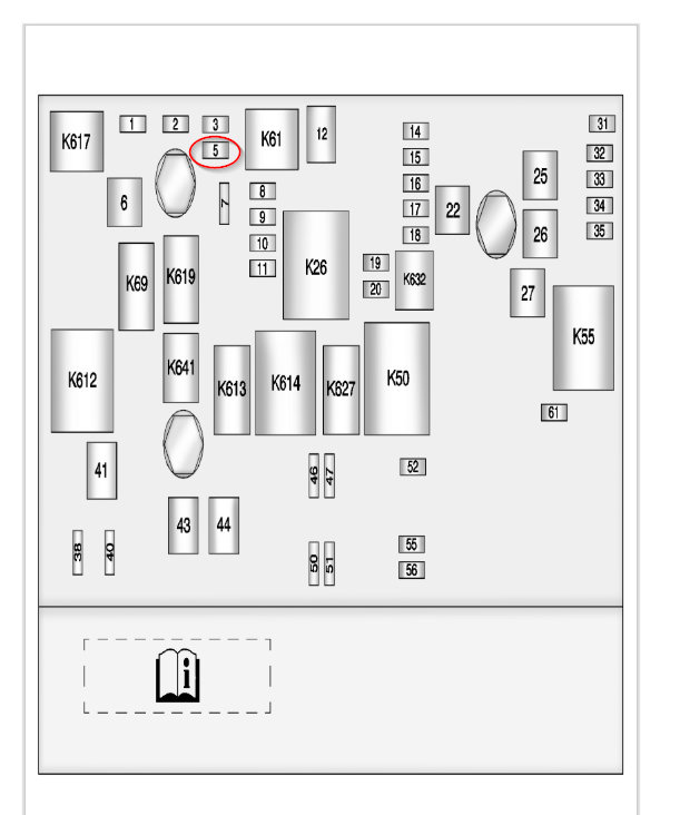

Wrong fuse box location. It is the # 5 engine control module fuse located in the fuse box under the hood.it is a 15. I guess I wasn't real clear on that important fact. sorry
Apr 10, 2020 at 6:20 AM
Okay. That helps but I should have figured that as it makes more sense. Is this the fuse that you are referring too? See attached. If it is then that feeds to the ECM directly which means that the ECM is most likely the short causing the failure.
However, before you replace an ECM, how often does the fuse blow? If it is pretty easy to get it to do it, I thinking you should try something. This voltage feed is for the ignition control for the ECM. I am wondering if we have a coil back feeding through the circuit and the 15 amp fuse is blowing prior to the circuit board on the ECM.
If this happens easily can you unhook each coil one at a time and then see if the fuse blows? Clearly you are going to introduce a misfire but if the fuse doesn't blow like normal with one of the coils unhooked, you may have an issue with that coil.
Let me know. Thanks
