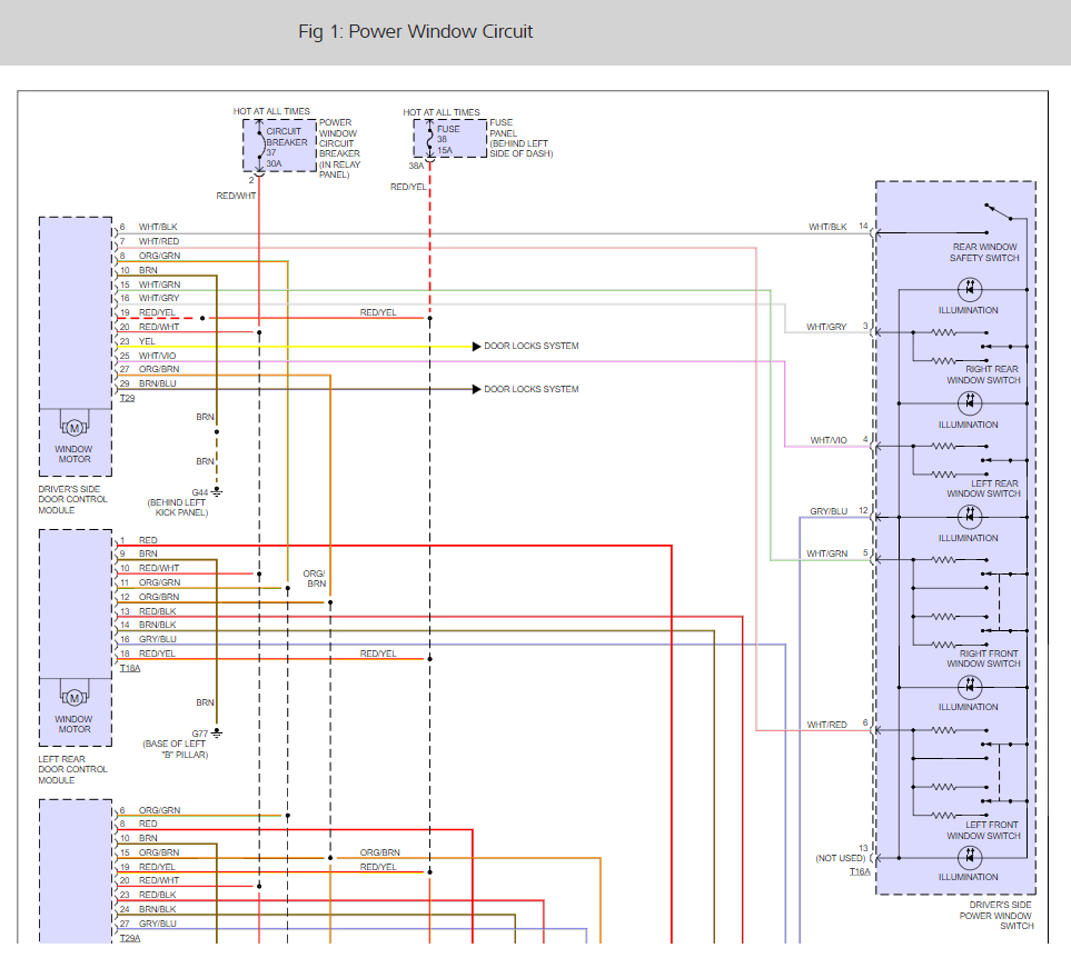

Hi, All windows and central locking system stopped working. i checked all fuses and they were okay, but i read some forums i heard some talking about a power window relay or power door relays which could be the culprit. i checked under the driver side and saw some relays, but cannot tell which is either power window or power door relay. can someone please tell me the location of this relay(s) and the number written on it?any help is appreciated. Thanks
