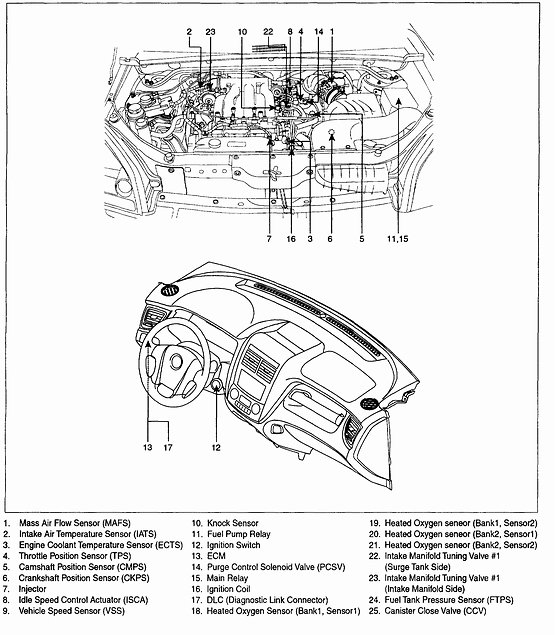

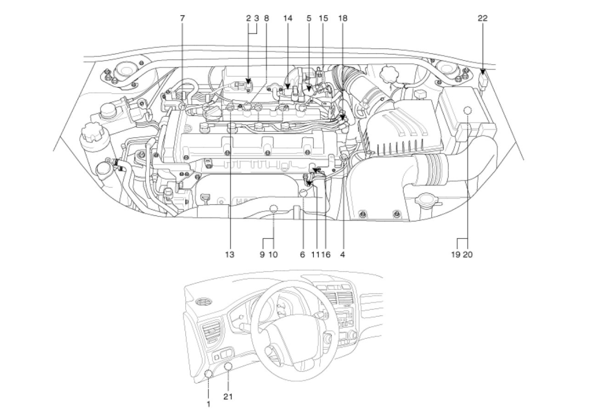

Hello, I'm Danny.
Here is a guide to help you step by step with instructions in the diagrams below to show you how on your car.
Check out the diagrams (Below). Let us know what happens and please upload pictures or videos of the problem.

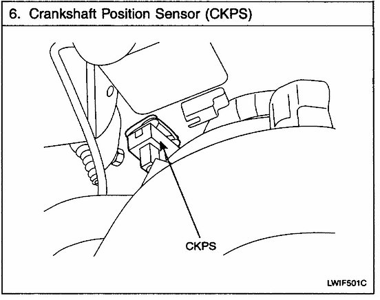

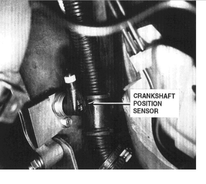

LOU P
  • 118 POSTS

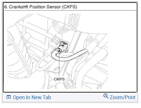

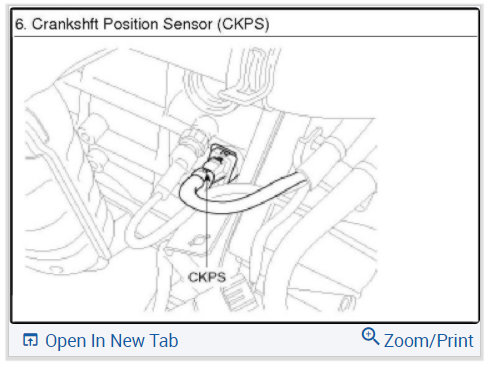

Here are two pictures from the service manual.

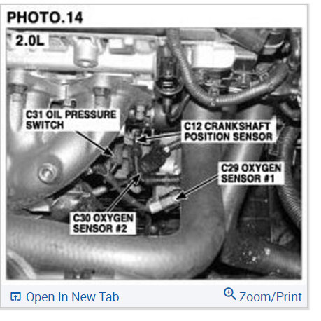

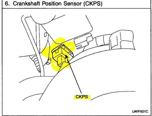

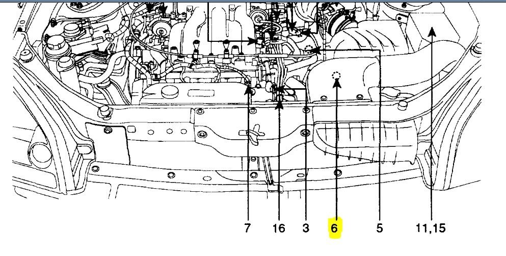

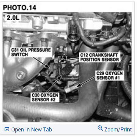

Welcome to 2CarPros.
I'm not sure if you have a 2.7L V6 or a 2.0L 4 cylinder. You listed two different things above. LOL
So, if you have the V6. you need to remove the fresh air duct under the hood. Once removed, the sensor is mounted on the engine. See pictures 1 and 2.

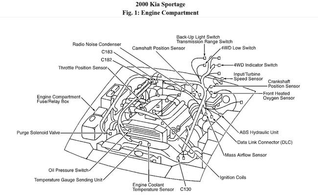

On the 4 cylinder, it is located near the oil pressure switch on the engine. See picture 3
Let me know if this helps.

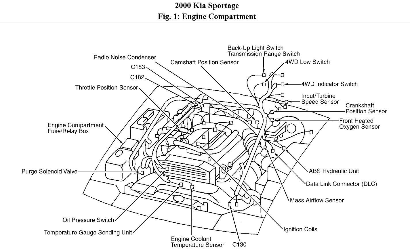

Hi i would like to know where is the crankshaft and camshaft position sensor locate for 2000 kia sportage 2.0 and is that easy to replacing that sensor.
Mar 26, 2021 at 10:37 AM (Merged)
Camshaft position located at rear of cylinder head. Crankshaft position sensor, located at lower left side of engine in the transmission bell housing.
Here is a guide to help you step by step when changing the sensor out with diagrams below to show you on your car.
Both sensors are bolted on with one bolt and replacement is simple, only problem could be accessing them due to location. You might need to jack the car up
Check out the diagrams (Below). Please let us know if you need anything else to get the problem fixed. Cheers

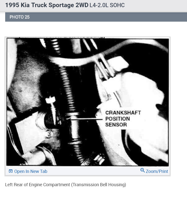

The book calls for .7 hours so figure around 40 minutes for replacement. The component is located in the left Rear of engine compartment (Transmission Housing). See picture 1. There is only one bolt that holds it in place. Here are the directions for replacement:

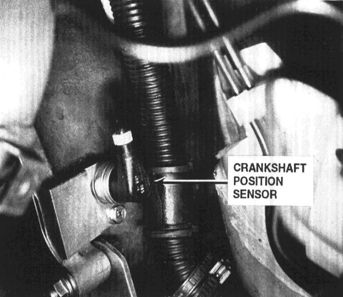

NICOLE GRIBBLE
How do I install a crankshaft position sensor on a 1998 Kia Sportage? Not sure where it goes...
Mar 26, 2021 at 10:40 AM (Merged)
WRENCHTECH
  • 20,761 POSTS
Here is a guide that will give you an idea of what you are in for when doing the job with the location of the sensor rear the rear of the engine. https://www.2carpros.com/articles/crankshaft-angle-sensor-replacement Here is the location for your car https://www.2carpros.com/images/external/78720253.jpg Please let us know if you need anything else to get the problem fixed. Cheers
