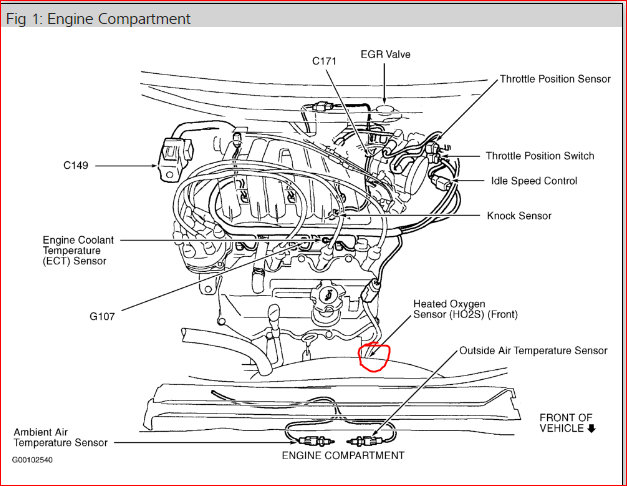

Where is the bank one sensor one oxygen sensor located at?

Hello, I am Danny.
I have attached a picture of its location and circled it in red. I have also attached a how-to link if it helps. Please feel free to ask any questions if needed and thanks for using 2CarPros.
Danny-
https://www.2carpros.com/articles/how-to-replace-an-oxygen-sensor
