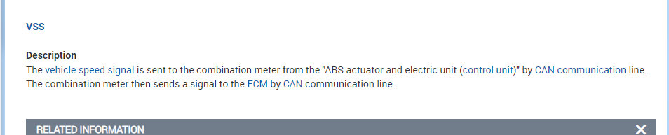

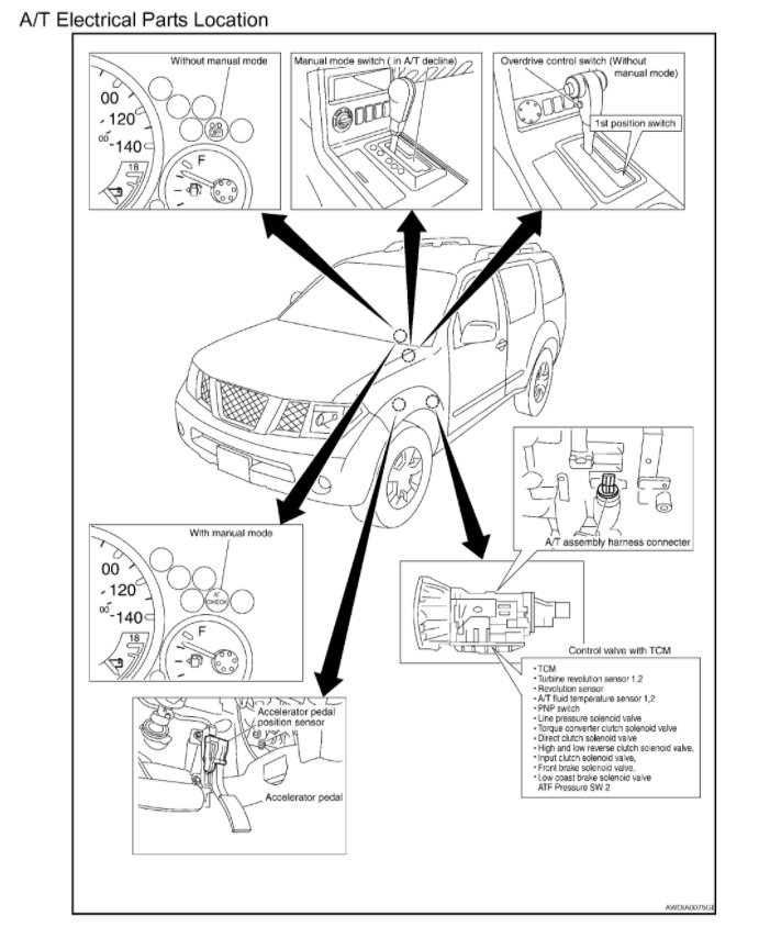

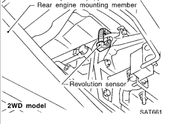

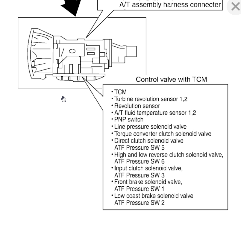

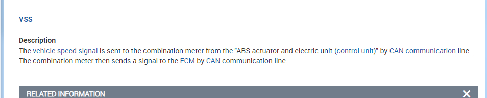

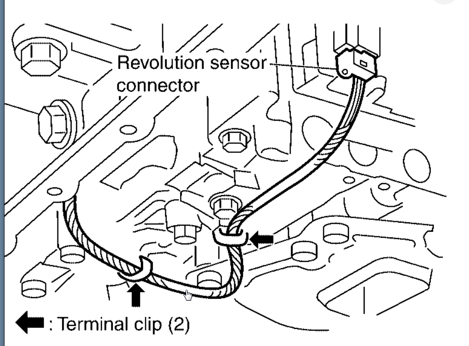

I have attached one pic above and it looks like they also call it a Revolution sensor. Yellow and orange and possible a black wire.
