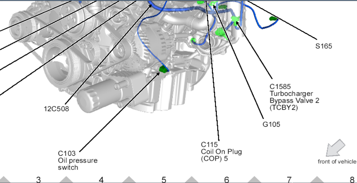

Oil gauge drops at idle.
Jan 1, 2019 at 8:55 AM
Good morning,
It is located under the alternator behind the oil filter adapter. I attached a picture for you to view.
Jan 1, 2019 at 9:01 AM
