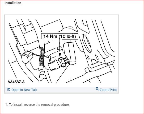

Where is the oil pressure sensor/switch located on the van listed above? Is there a diagram showing location?
Apr 24, 2019 at 7:58 AM

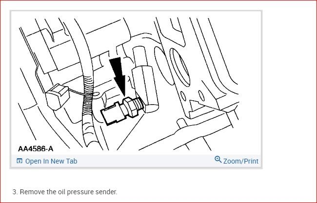

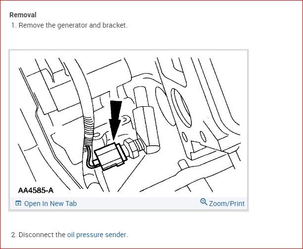

Hi Ron,
These are not the best illustration to show you orientation but this is under the alternator and alternator bracket. Once you get those out of the way you will see a sensor that looks like the one in the illustrations. That is your oil pressure sender.
