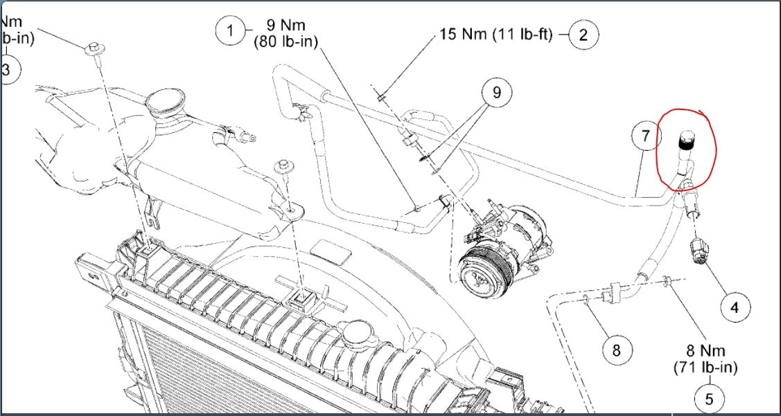

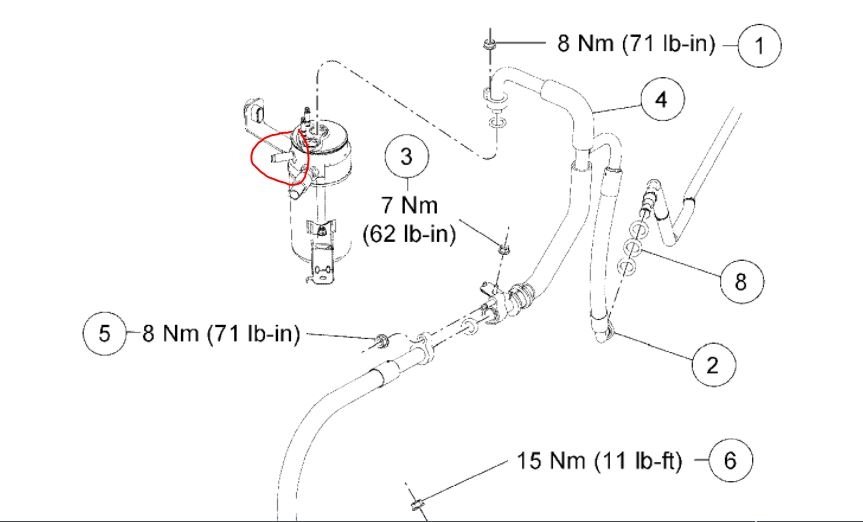

I am looking for the low pressure port on the vehicle listed above. I am having troubles locating it.
Mar 30, 2021 at 12:42 PM
Good afternoon,
I attached pictures of the low and high side ports below for you to view.
Check out the diagrams (Below). Let us know what happens and please upload pictures or videos of the problem.
