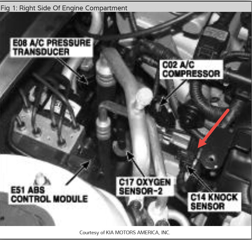

CARRIE CHRIS KLERKS
Trying to find location of knock sensor.

if it knocks you need to find out why before you replace knock sensors. as any noise sets them off. it may be a serious problem.
