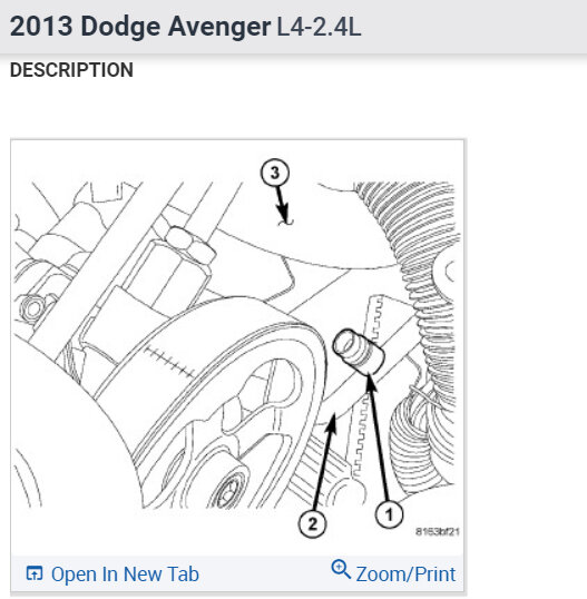

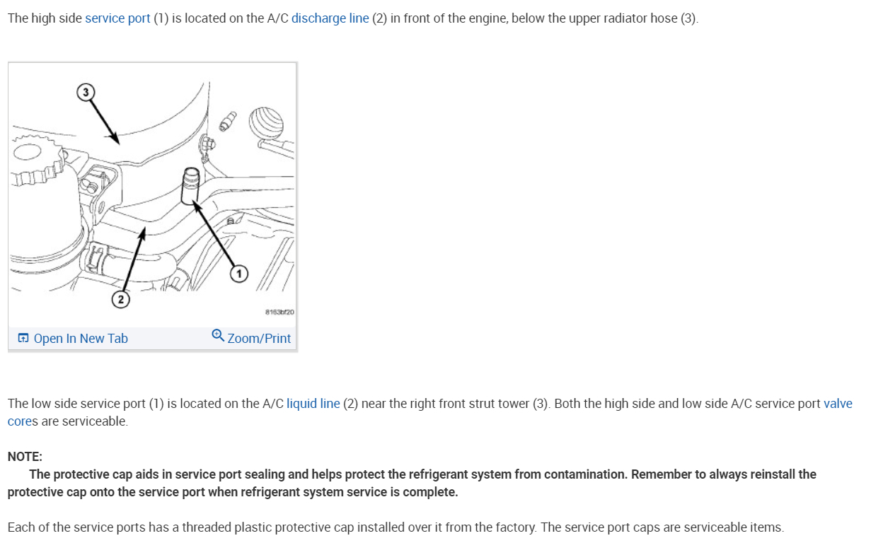

Check out the images (below). Please let us know if you need anything else to get the problem fixed.

are you saying the low side port is on the passenger side near the strut? Do i have to pull the wheel to see it? My other question was, how do I remove the front grill to check the condenser for leaks?

Yes, you may need to remove the tire and the fender well. For the grill issue please create a new question. We only handle one problem per thread, please post your new question here, you must be logged in.
