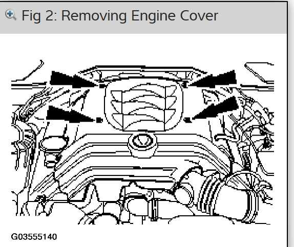

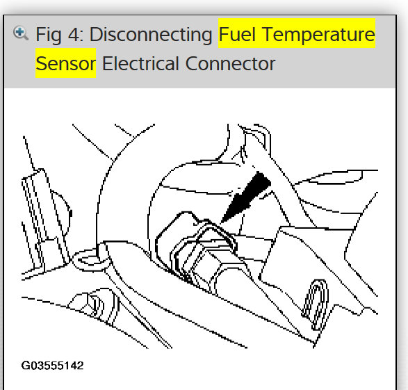

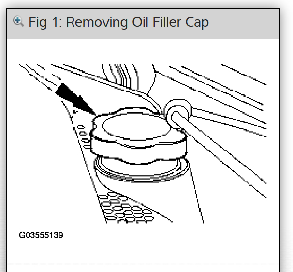

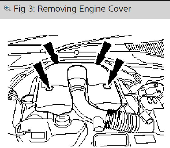

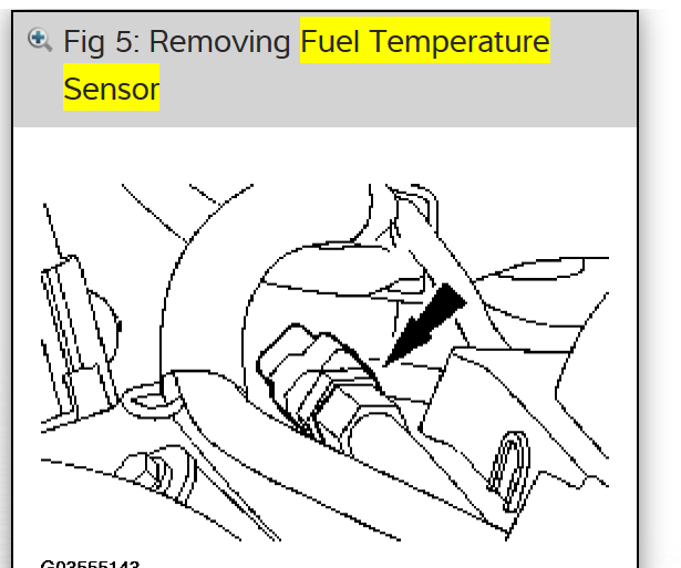

Where on the engine the fuel temperature sensor fits?
Jul 12, 2017 at 5:12 AM
HMAC300
  • 48,601 POSTS
see pictures for removal. install is reverse of removal. Non supercharged shown. Picture is on fuel rail. Check out the diagrams (Below). Please let us know if you need anything else to get the problem fixed.
