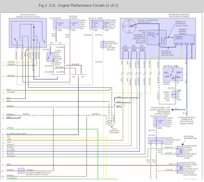

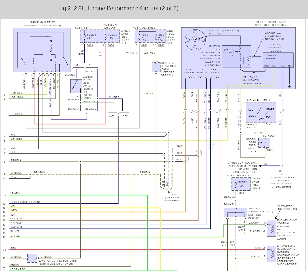

The relay is the PGM-FI relay behind the left side of the dash.

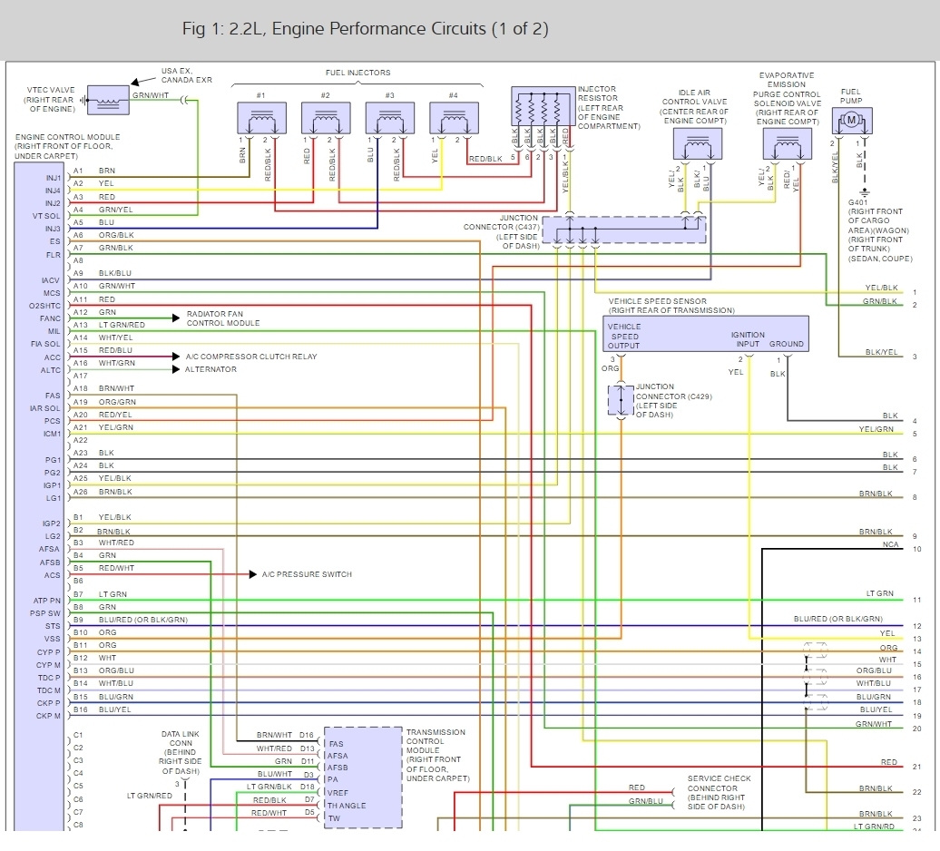

Here is its location and wiring of the relay.
