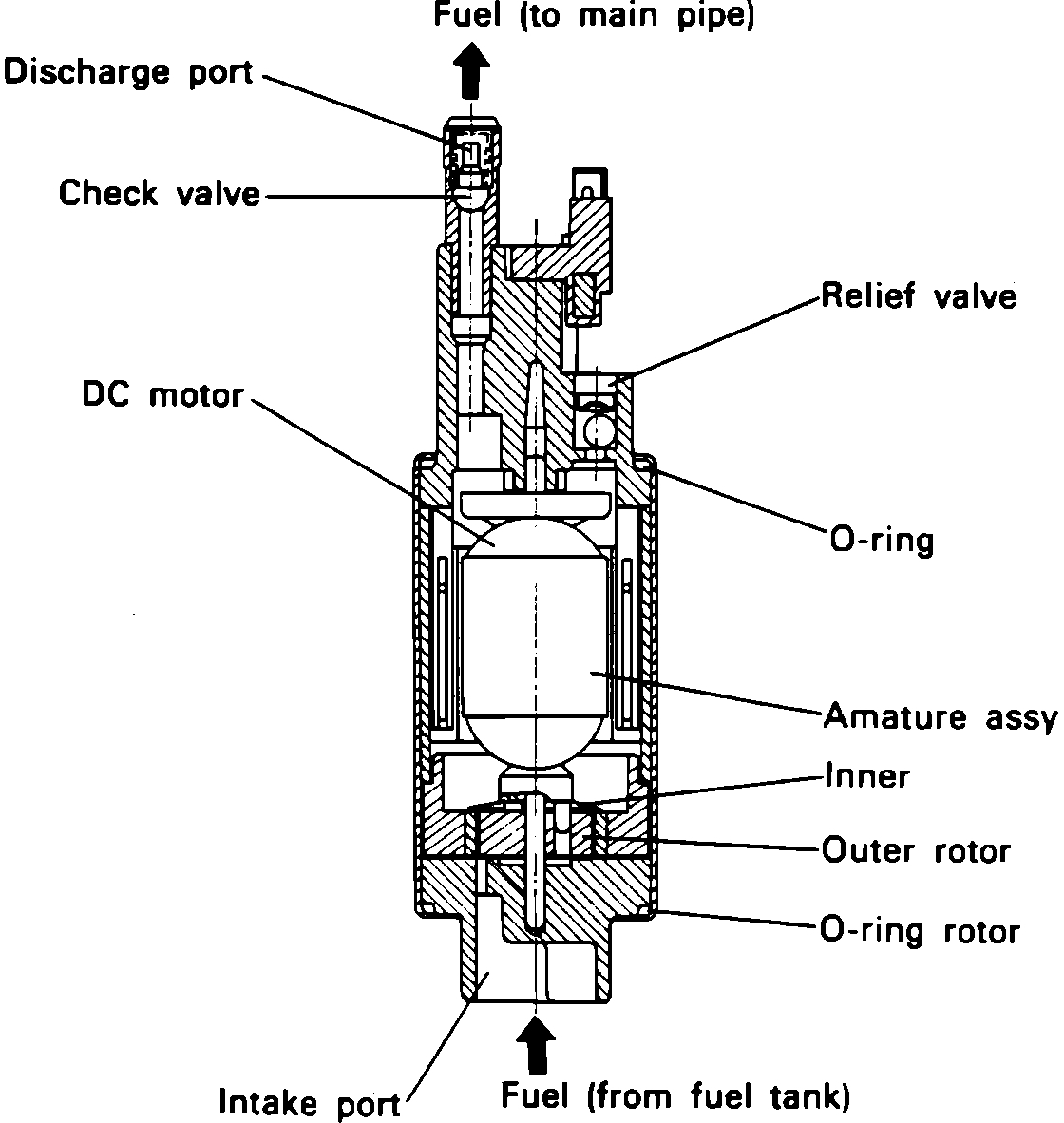

For some reason, the Lancer is not listed in any of my manuals. However, I believe in 1993, the Mirage was based on the same platform. With that in mind, the fuel pump is electric and is located in the fuel tank. Here is a test you can do to check if it is working:

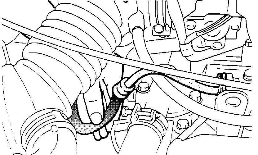

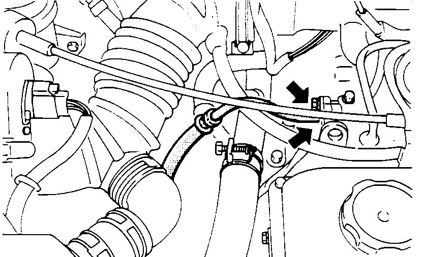

1. Turn the ignition switch OFF
Fuel Pump Power Hook-up
imageZoom/Print

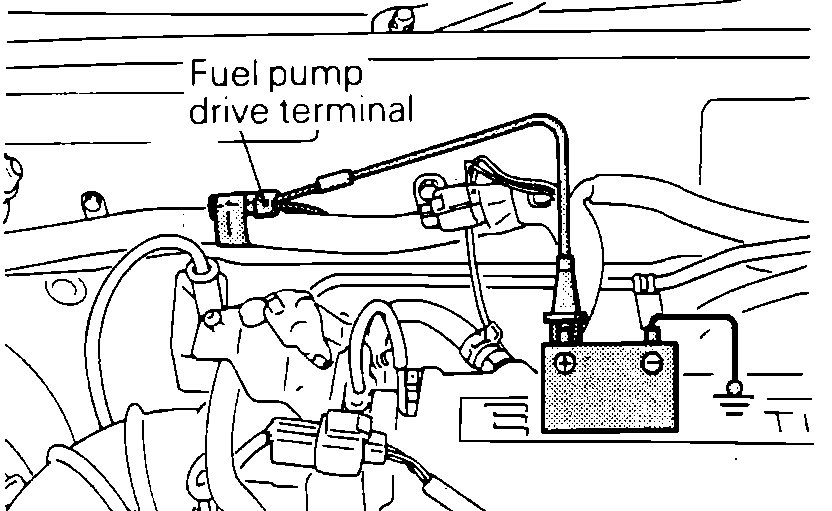

2. Apply battery voltage to the fuel pump drive connector to power the fuel pump.
Fuel Pump Operational Test
imageZoom/Print
3. Pinch the fuel hose to check that fuel pressure is felt.
NOTE: The fuel pump is mounted in the fuel tank and it operates submerged in fuel, therefore its operating sound is hard to hear without removing the fuel filler cap.

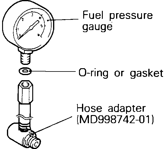

Fuel Pressure Testing Equipment And Adapter
imageZoom/Print

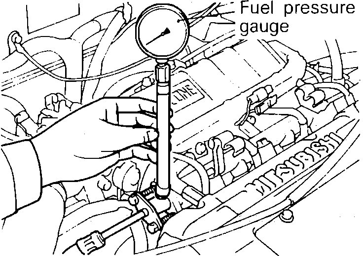

Fuel Pump Pressure Test Equipment Installed
imageZoom/Print
3. Using the fuel pressure gauge adapter (MD998742-01) or equivalent, install the fuel-pressure gauge to the delivery pipe (fuel rail).
4. Connect the battery negative terminal.
5. Apply battery power to the fuel pump drive terminal to activate the fuel pump. With fuel pressure applied check that no fuel is leaking at any of the connections.

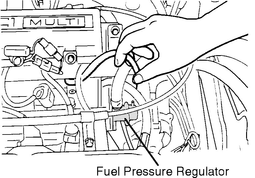

Fuel Pressure Regulator W/Vacuum Line Disconnected
imageZoom/Print
6. Disconnect the vacuum hose from the pressure regulator, and plug the hose end. Measure the fuel pressure at idle.

8. If the results of the measurements made in steps 6 and 7 are not within the standard values, refer to the symptoms listed below to determine the probable cause and make the necessary repairs before re-testing.
a. Fuel pressure too low:
1. Clogged fuel filter---Replace
2. Fuel bleeds down to return hose---Replace the fuel pressure regulator
3. Low pump output pressure---Check for leak in-line or replace fuel pump
b. Fuel pressure too high:
1. Regulator stuck closed---Replace the fuel pressure regulator
2. Clogged or bent fuel return hose---repair hose
c. No difference with or without vacuum connected:
1. Non-responsive regulator---Replace the fuel pressure regulator
2. Plugged vacuum line or no source vacuum---replace line or repair vacuum source
