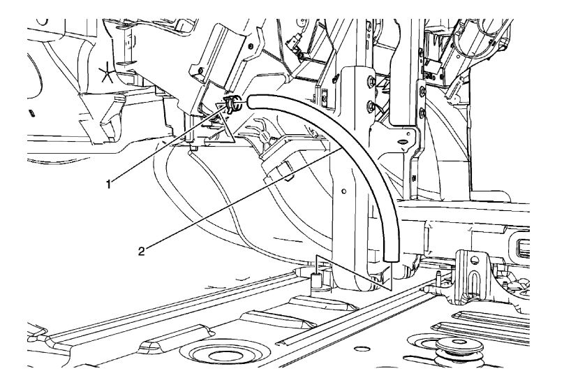

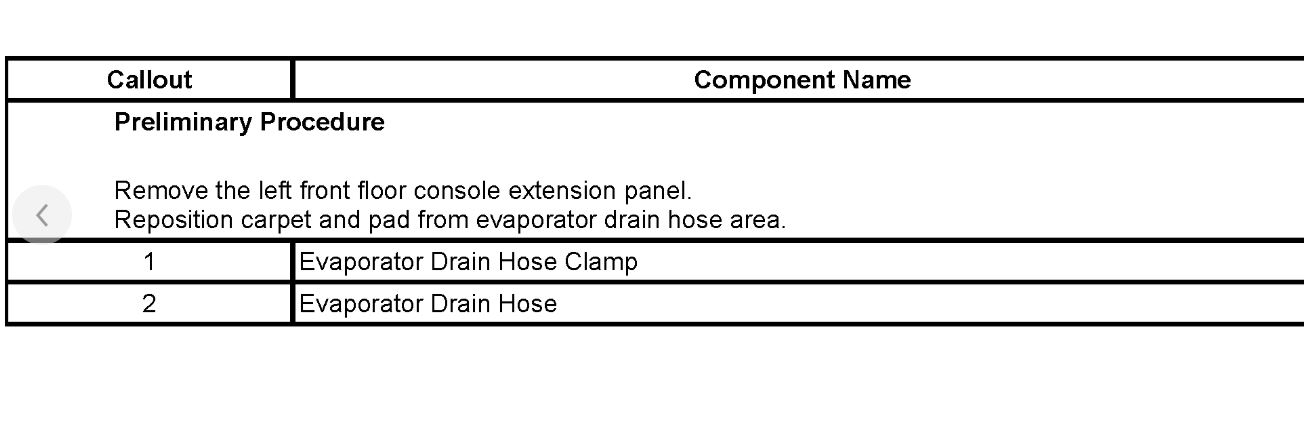

Getting water in front passenger floor when running A/C. Hear s sloshing sound when turning the water comes down. Have made sure the hose and drain plug behind drivers side floor panel next to gas paddle is clear. no water from tube and water flows freely down through that plug.
Seen videos and articles on GM vehicles having a drain pipe/tube in engine compartment next to firewall that could be plugged, but am unable to find it. Have tried looking behind engine from top and under it. Anyone know where this is at exactly?
