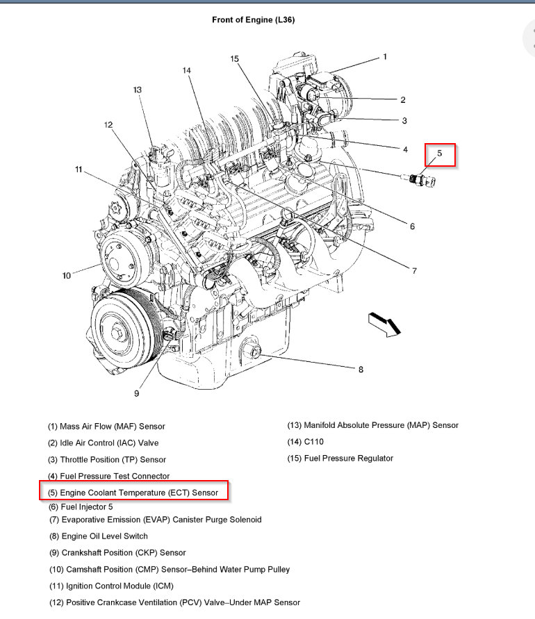

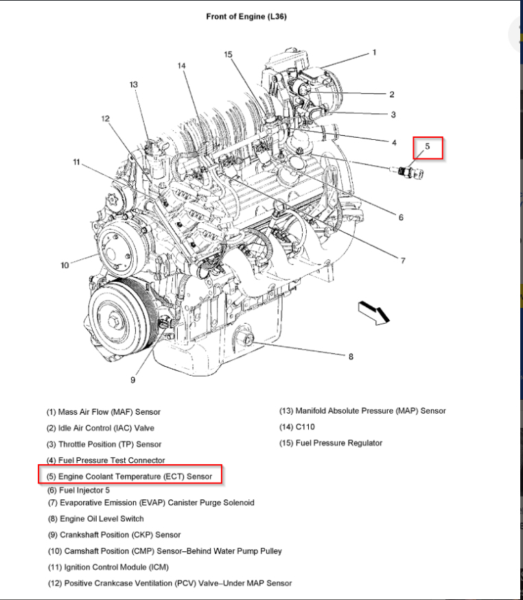

I have checked out your article, but am not able to find where the coolant temperature sensor is located in order to replace it. I have the new part, but cannot find where to install it.
Feb 29, 2020 at 1:37 PM
I attached the location of the sensor. Let me know if you need more info. Thanks
Feb 29, 2020 at 1:50 PM

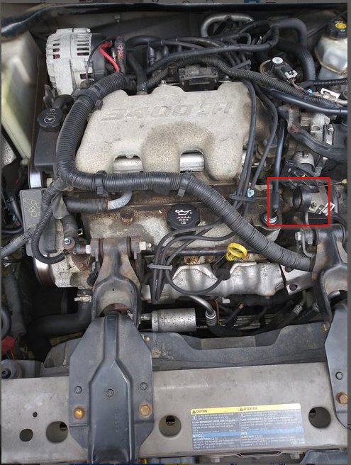

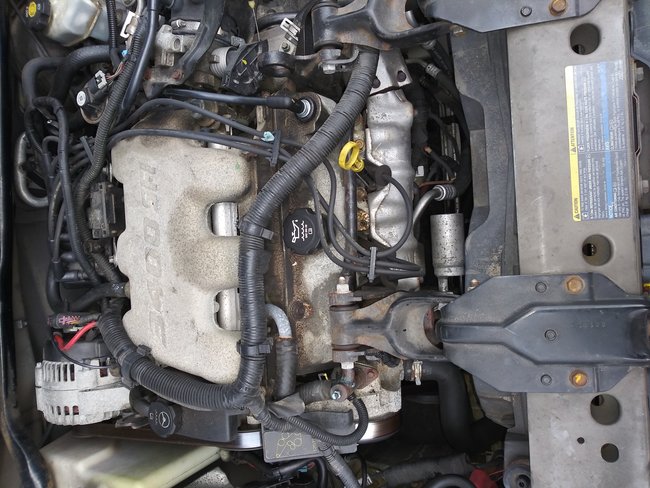

Thanks, but I still am not sure where it is. I have included pictures of my engine.
Feb 29, 2020 at 1:57 PM
It is not visible in the picture you provided but it is located in the red square on the photo. Basically under the throttle body you will see the thermostat housing. Once you locate the thermostat housing you will see a connector for a sensor. That will be the ECT.
