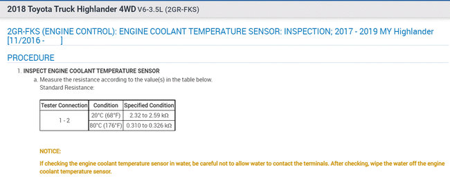

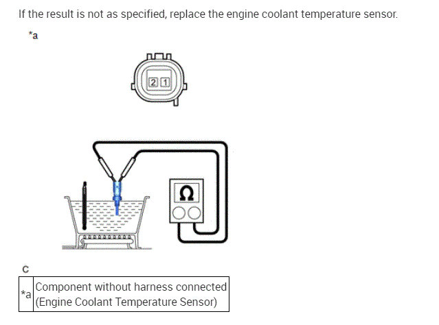

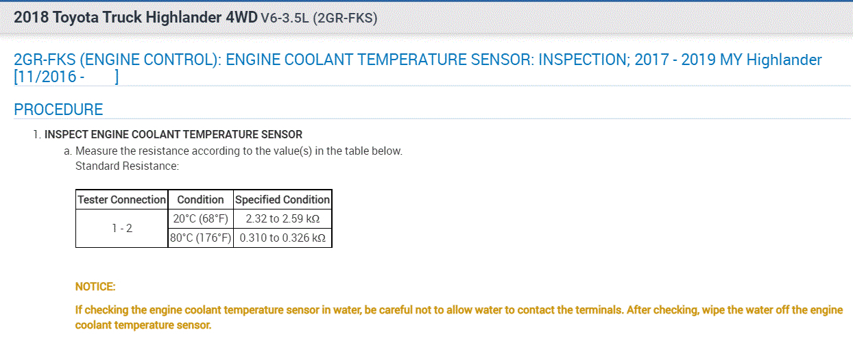

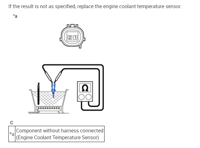

First, the P0000 is really an odd one to see. It basically means nothing or there are no codes. The P0128 simply indicated the engine isn't warming up in an acceptable amount of time. Often times this is a stuck open thermostat, but it can also be related to the engine coolant temperature sensor not working properly. Remember, if the PCM receives a signal from the sensor, it doesn't know if it is right or wrong. Instead, it knows there is a signal and that is what it goes with.
What I would suggest at this point would be to inspect the engine coolant temp sensor. If you look at the pics below, they provide the directions for testing.
Try this and let me know what you find,
See pics below.

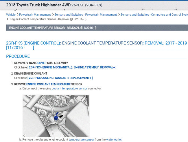

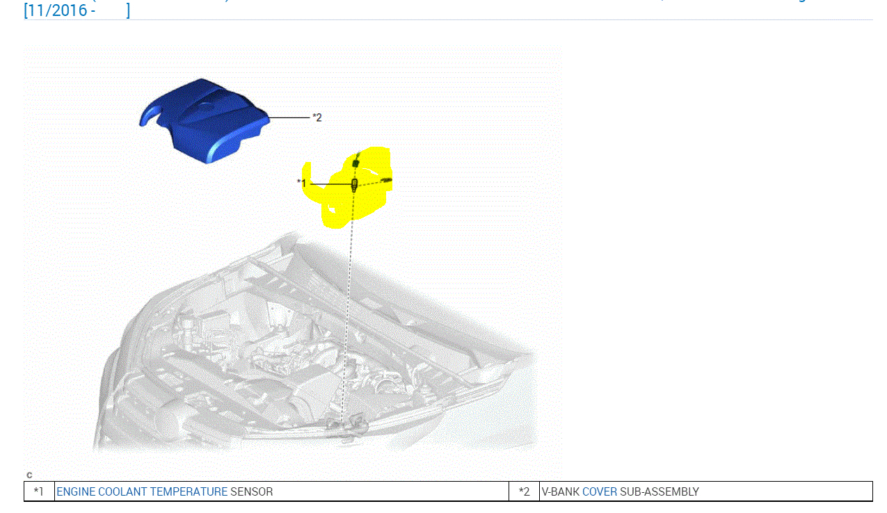

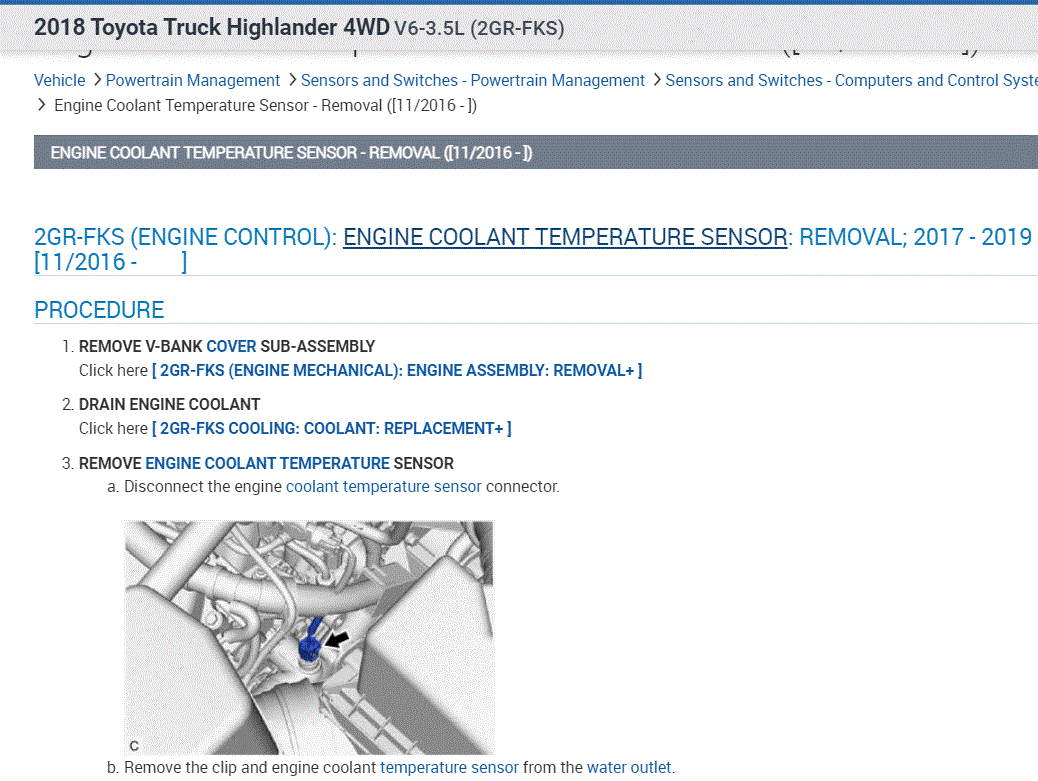

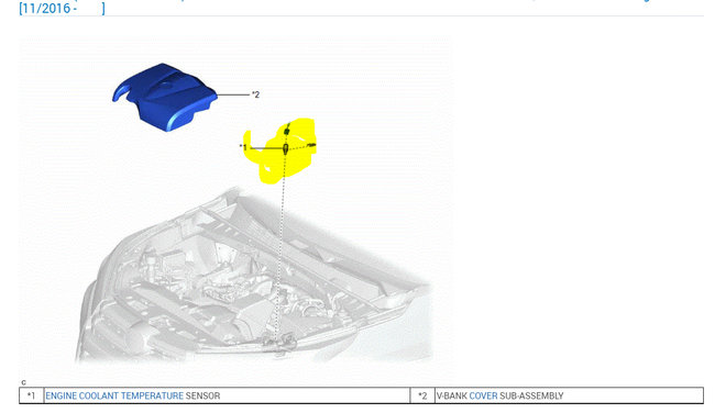

Thank you for your reply. Where is the sensor located?
Jan 19, 2022 at 8:13 PM

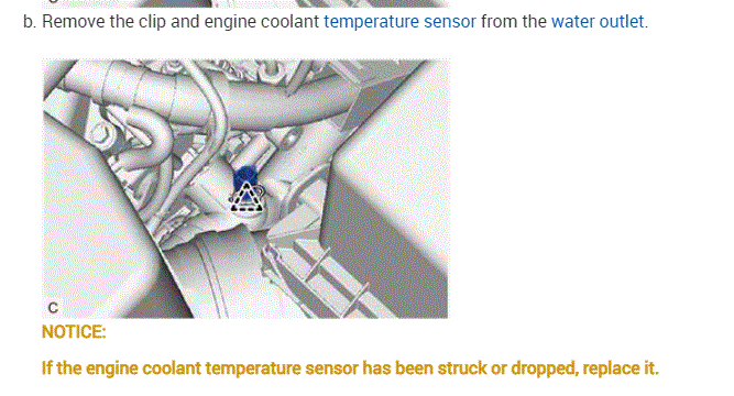

If you look below, it shows sensor location. To test it, it will need to be removed. Pics 2 and 3 are the vague (LOL) removal and replacement directions from my manual. Here is a link you may actually find more helpful.
https://www.2carpros.com/articles/coolant-temperature-sensor-cts-replacement
Let me know if this helps or if you have other questions. Also, make sure the connector isn't loose, damaged, or corroded inside when you check.
See pics below.
