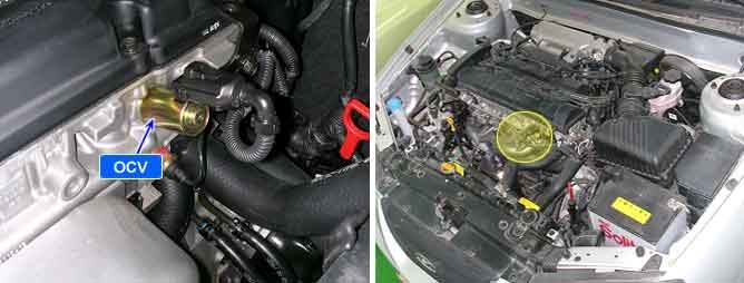

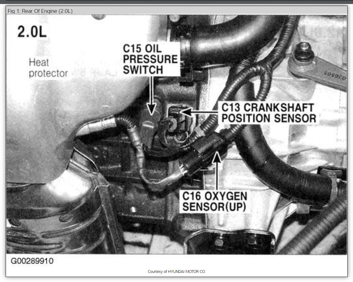

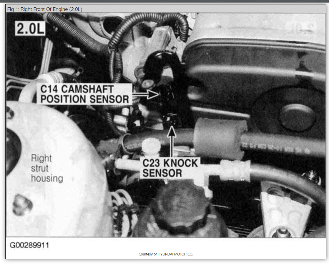

This is the exact location of the camshaft sensor for the vehicle you provided. It is held on by a 10mm bolt. Once the connector is disconnected and the bolt is removed, you may need a set of pliers to work the camshaft sensor side to side in order to get it to break loose from its grip on the head assembly. Best of luck!
