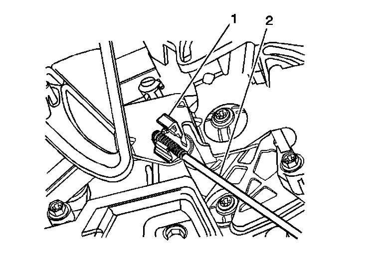

4. Open the mode actuator push rod retainer clip (1) with a small flat-bladed screwdriver.
IMPORTANT: Count the number of threads showing from the tip of the mode actuator push rod to the end of the retainer clip.
5. Disconnect the mode actuator push rod (2) from the retainer clip (1).

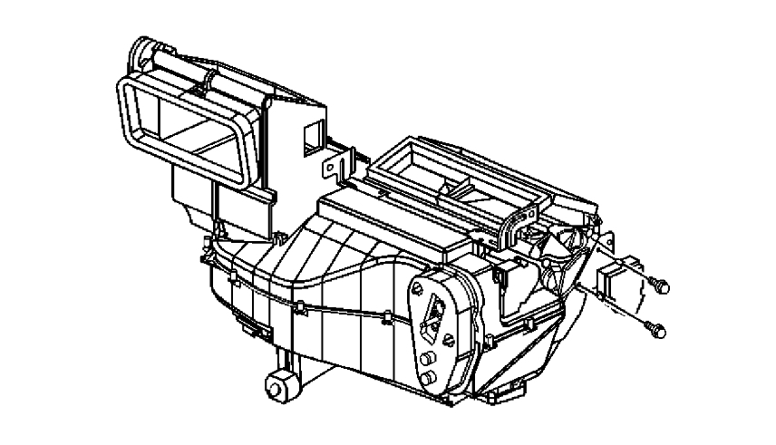

6. Remove the mode actuator mounting screws.
7. Remove the mode door actuator.

3. Connect the mode actuator push rod (2) to the retainer clip (1).
IMPORTANT: Align the counted number of threads on the mode actuator push rod (2) with the tip of the retainer clip (1).
4. Close the push rod retainer clip (1).
