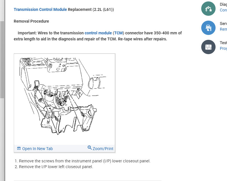

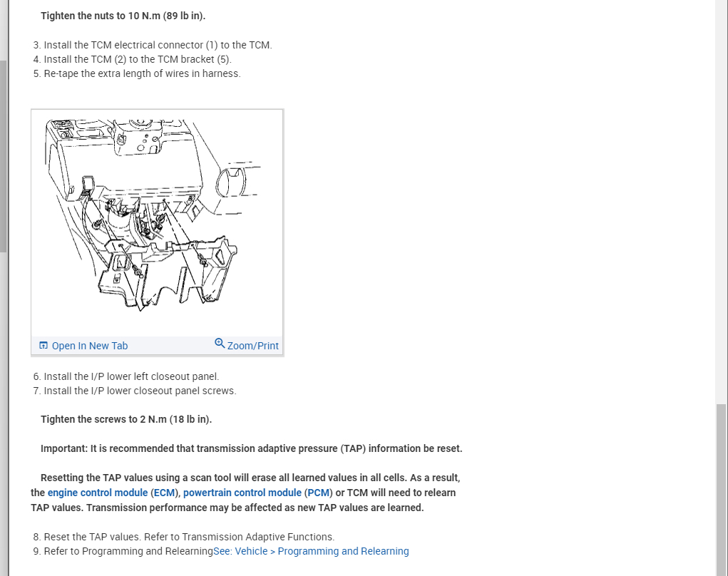

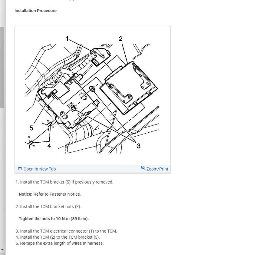

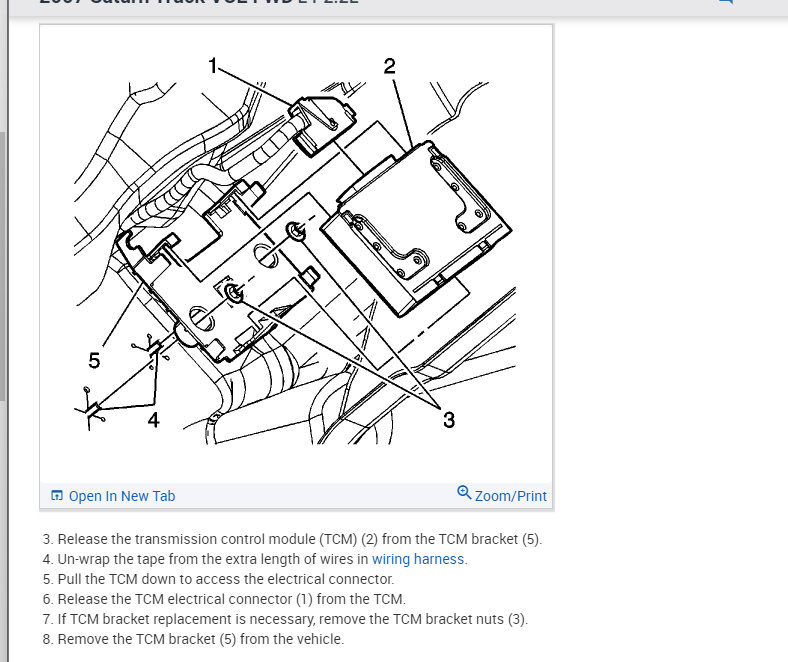

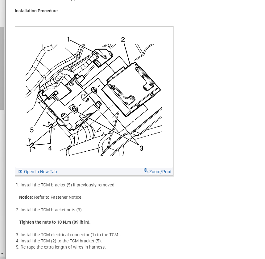

I am trying to find the TCM, i looked on the picture but there/not even in the engine compartment, there is no TCM under the battery not even in the steering column compartment. i tried to look next to the shock absorber mounting as what in the picture nothing. Where is it?
