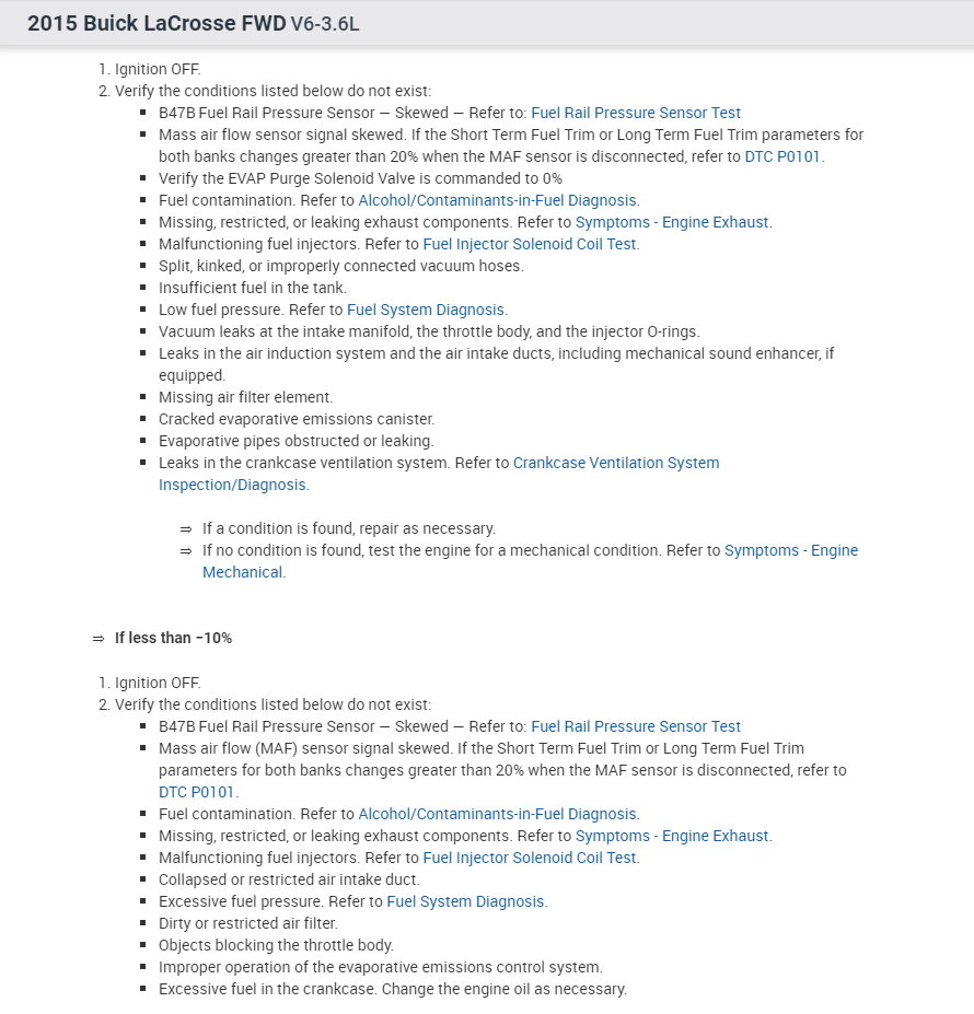

Keep in mind this code can get triggered due to faulty wiring for the oxygen sensor as well as other components.
There are oxygen sensors located after the catalytic converter on the exhaust pipe.
Best course of action to take a deeper dive and trouble shoot this rather than just replacing parts.

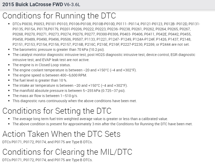

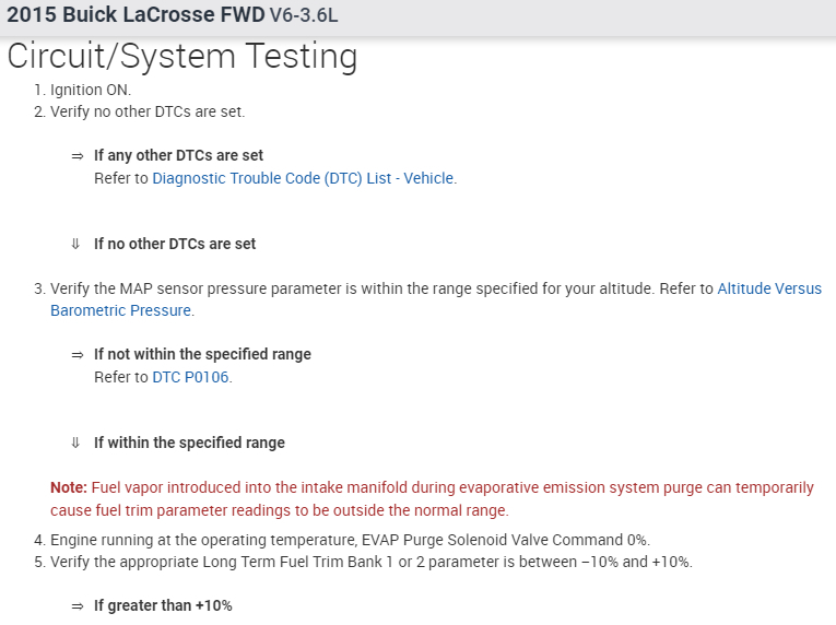

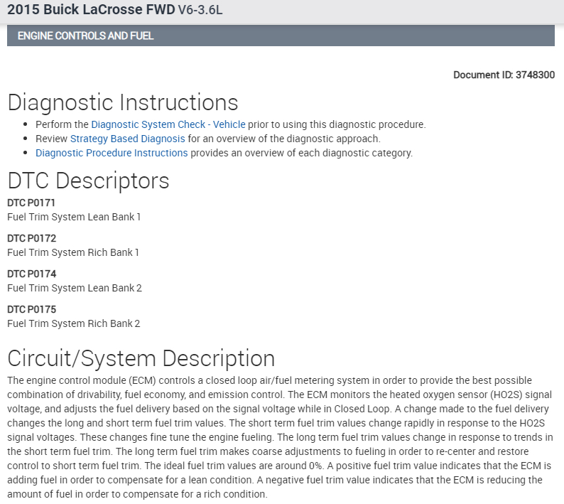

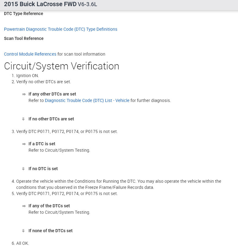

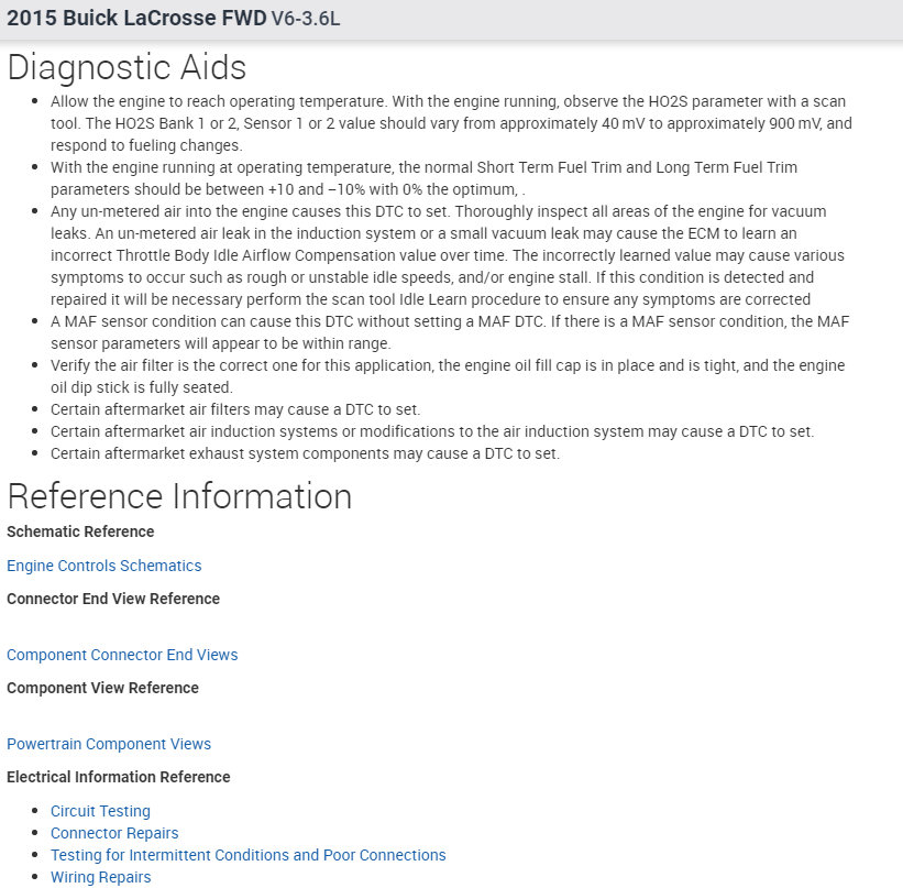

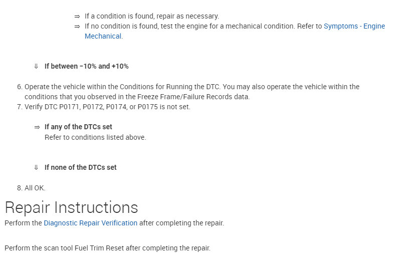

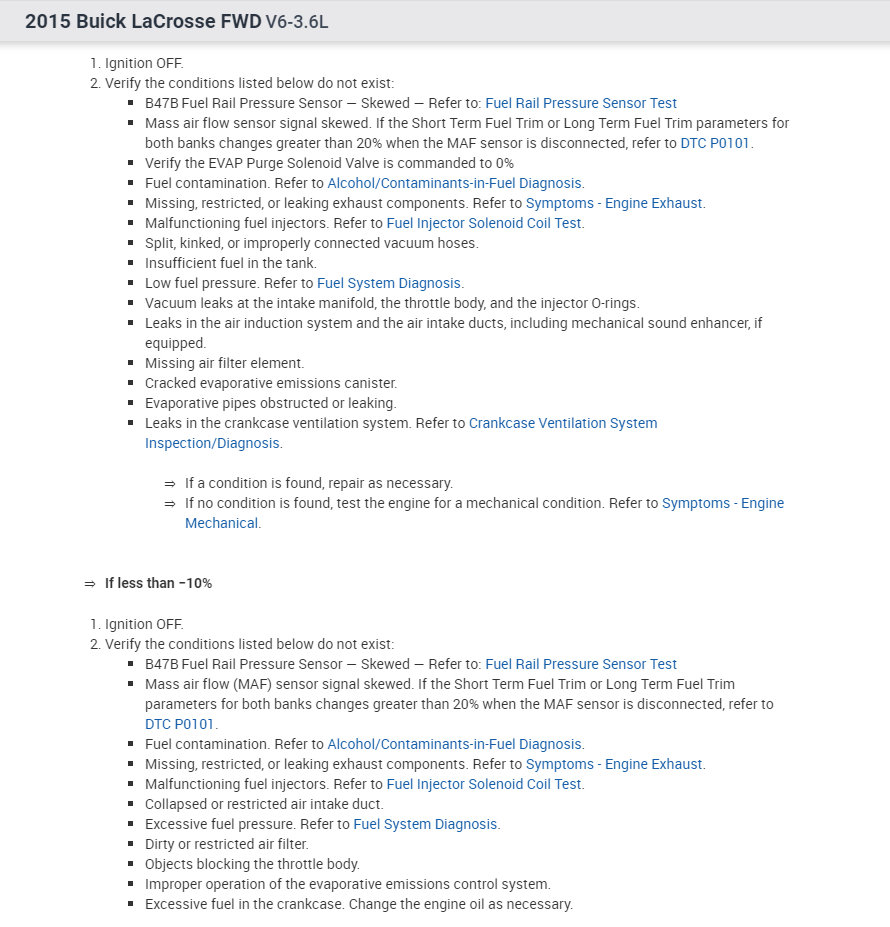

I have attached the troubleshooting guide for the code P0171 and P0174 below. Got through the procedure as that can help you determine the issue.
