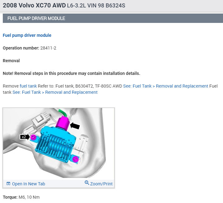

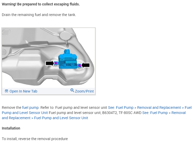

Hello,I'm Danny.

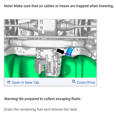

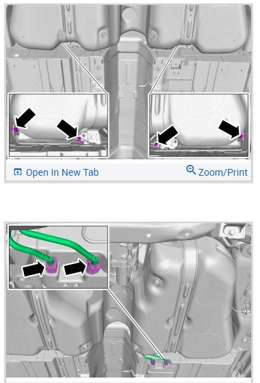

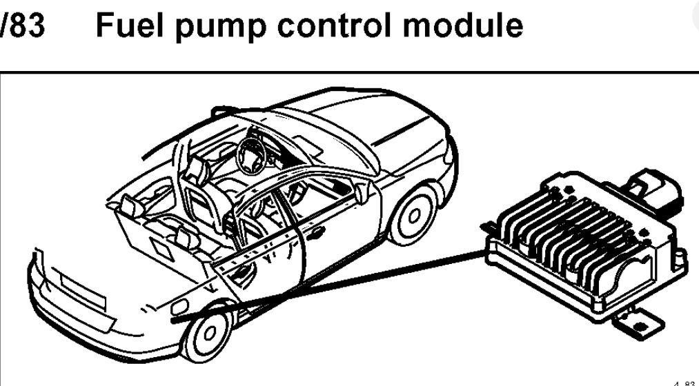

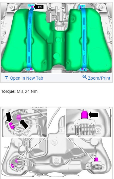

The fuel pump driver module is located on top of the fuel tank. I've attached pictures below of its location. If you would like I could also supply step-by-step instructions on how to remove your fuel tank.It's a big job.Hope this helps and thanks for using 2CarPros.

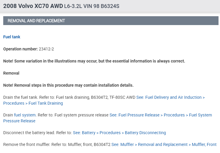

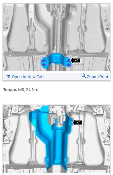

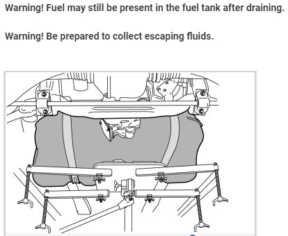

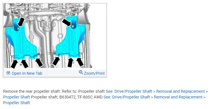

DANNY L
  • 5,648 POSTS
Hello again,

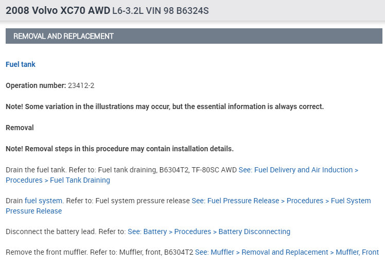

Okay, I've attached step-by-step picture instructions below on how to remove the fuel tank to gain access to the fuel pump module.Hope this helps and let me know if you have any further questions.Thanks again for using 2CarPros.
