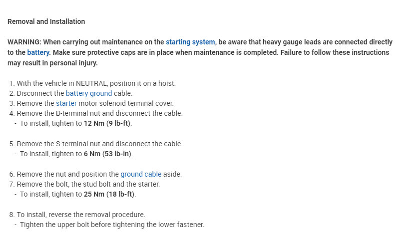

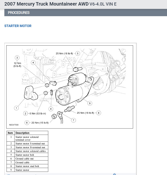

The starter is located on the lower left side of the engine.
Before getting the starter, you want to make sure to disconnect the battery.
The starter is mounted with 2 bolts.
Before removing the bolds you want to first remove the wire.
Here is a helpful guide:
I have attached the replacement procedure below for your reference.
Let me know of any questions.
