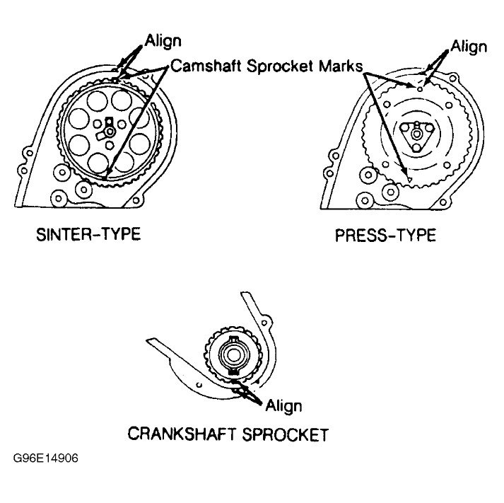

i am replacing timing belt on my car and would like to know where to position all timing marks before i remove belt and tensioner.

there are two different types of cam gear both are shown in picture.
Image (Click to enlarge)
