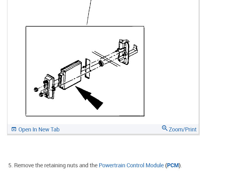

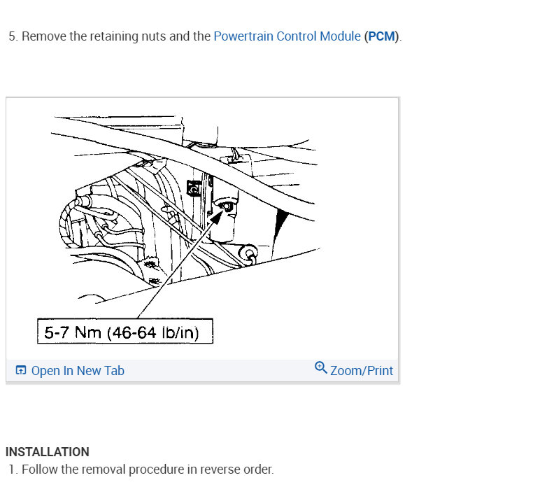

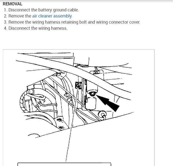

would like to know where the PCM is located.
Jul 24, 2023 at 5:56 AM
CERTIFIED EXPERT
53,854 POSTS
The engine control module or PCM is located on the driver's side firewall under the hood, Check out the images (below). Please let us know if you need anything else to get the problem fixed.
