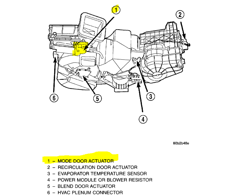

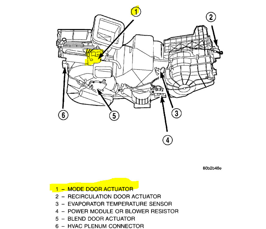

Here are the directions for replacement. The pic attached correlate with the directions.
___________________________________________________________
2000 Chrysler Concorde V6-2.7L VIN R
Mode Door Actuator Replacement
Vehicle Heating and Air Conditioning Air Door Actuator / Motor Service and Repair Procedures Mode Door Actuator Replacement
MODE DOOR ACTUATOR REPLACEMENT
The mode door actuator is an electric motor. It mechanically positions the A/C unit panel/bi-level door and the floor/defrost door. This actuator contains a feedback strip which allows the computer control to know the exact position of the mode door at all times. The mode door actuator is not serviceable and must be replaced if found to be defective.
Mode Door Actuator Locations
See Pic 1
The mode door actuator is located on the lower left side of the HVAC unit housing.

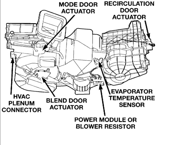

The temperature blend door actuator is on the passenger's side attached tot he heater plenum. Here is a guide to show you what you are info when doing the job.
Here is a diagram (Below) for the location on your car

The temperature door actuator is located at the bottom of the heater housing at the center tunnel.
REMOVAL
Negative Battery Cable Remote Terminal
Open hood and disconnect the negative battery cable remote terminal from the remote battery post.
Remove left and right underpanel silencer/ducts.Instrument Panel, Gauges and Warning Indicators/ Instrument Panel/ Service and Repair. See: Instrument Panel, Gauges and Warning Indicators\Instrument Cluster / Carrier\Service and Repair
Remove two screws from actuator which are accessible from the right side of center stack.
Remove one screw from actuator on left side.
Pull actuator straight down from shaft and disconnect electrical connection. Upon removal, note the shaft position of the actuator, because the shaft on this motor is keyed. when installing new actuator, its shaft must be positioned in the same location.
