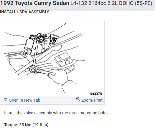

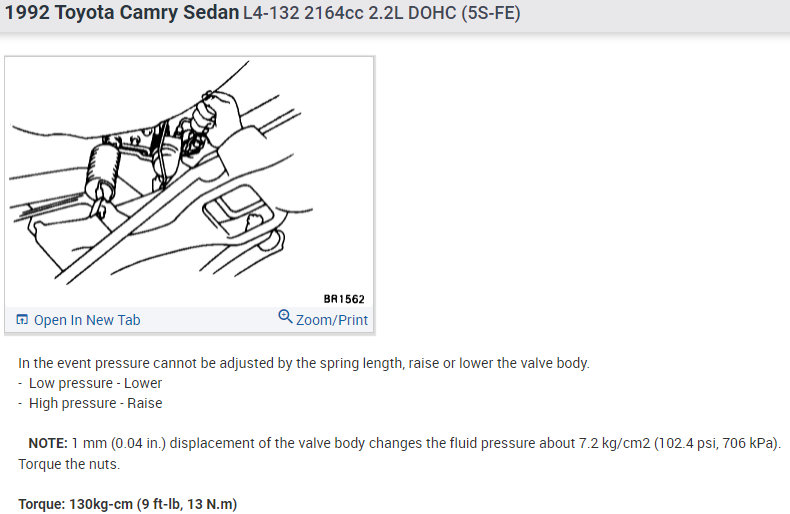

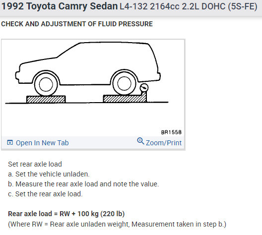

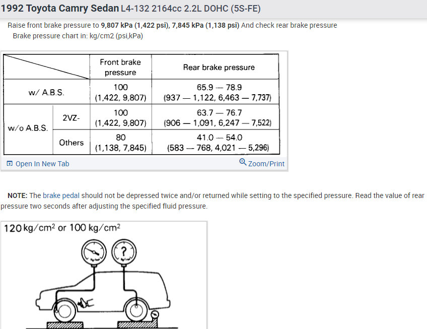

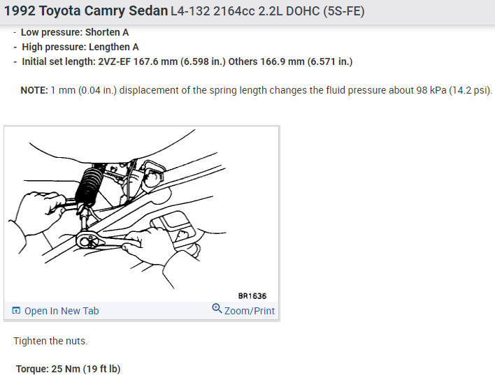

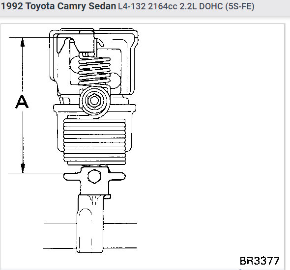

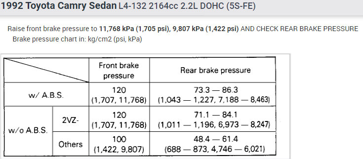

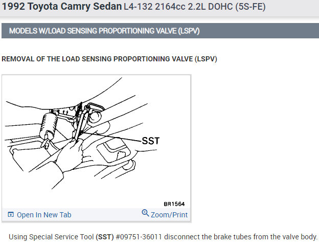

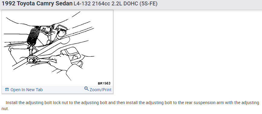

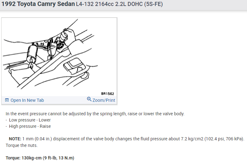

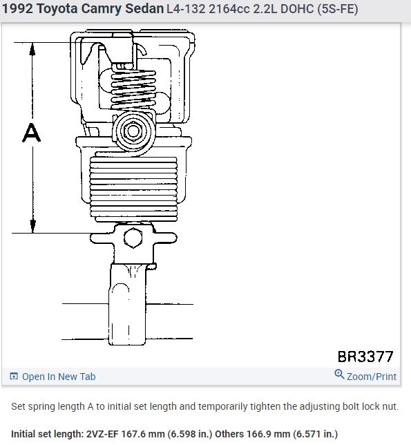

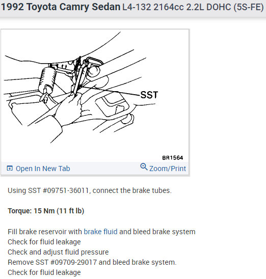

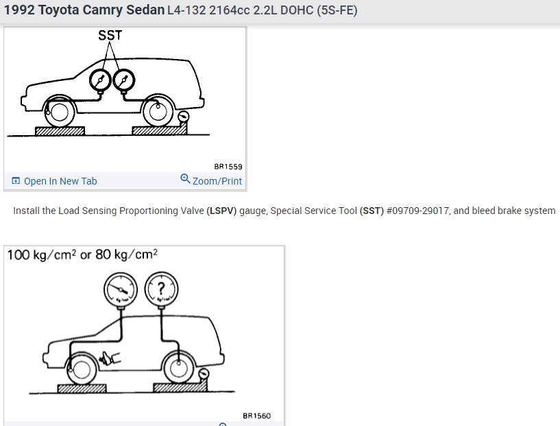

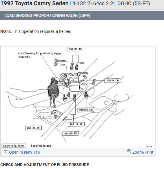

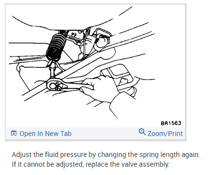

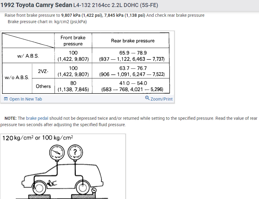

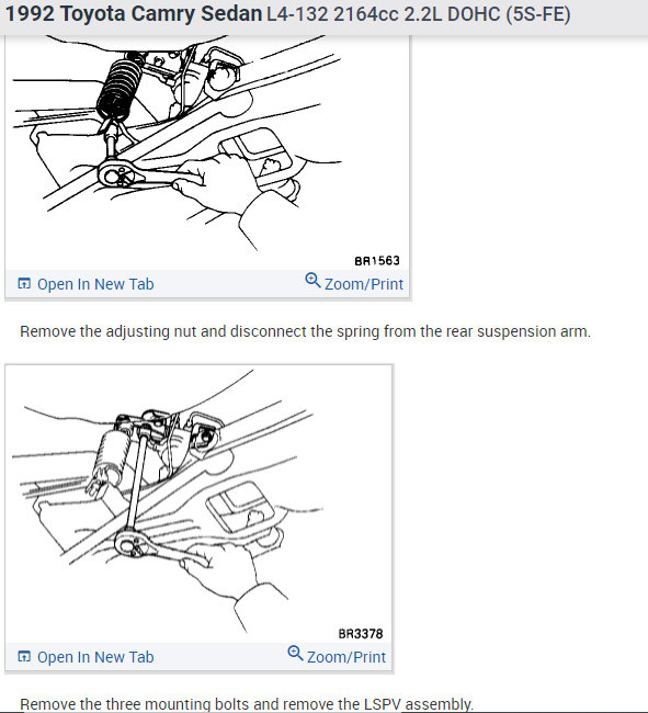

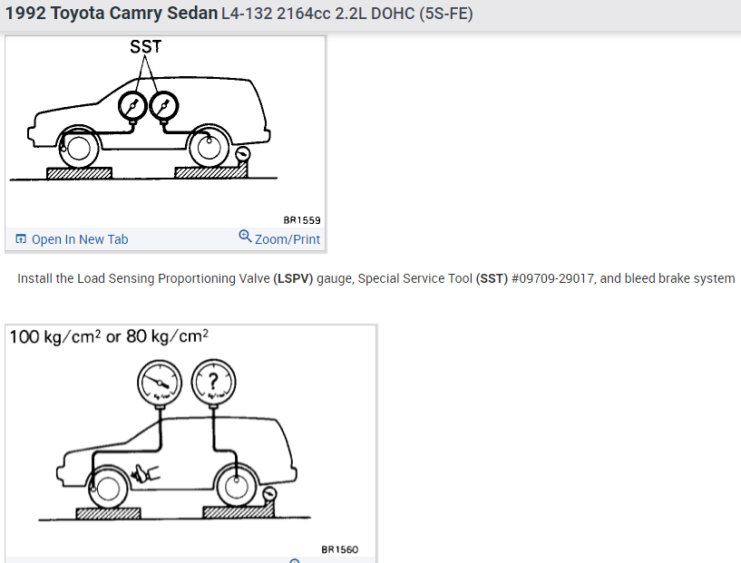

It is somewhat of a common issue, Toyota still makes the parts for it. However as far as we know you can only get the whole valve, not just the rod. Unless of course you get lucky in a salvage yard.
I have attached the testing and replacement procedure for the LSPV.
You will have to bleed the brake system afterwards:
https://youtu.be/w7gUsj2us0U
Any questions please let me know.
Thank you.
