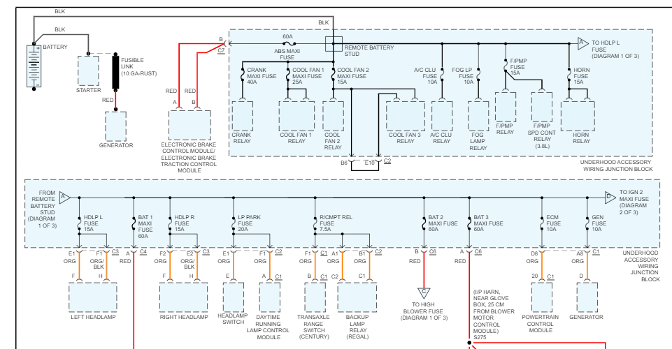

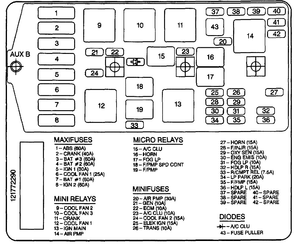

I am trying to locate the little mega fuse.
Aug 14, 2023 at 9:21 PM
CERTIFIED EXPERT
53,855 POSTS

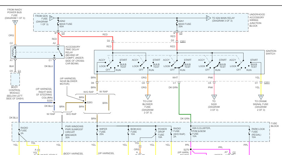

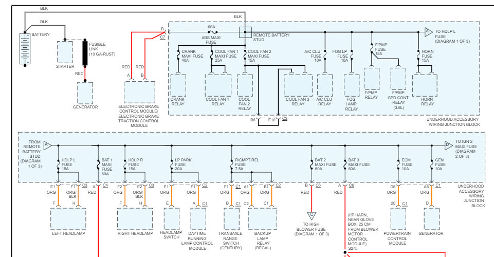

Little? There are many here is a wiring diagram to help clarify. Check out the images (below). Please let us know what you find.
