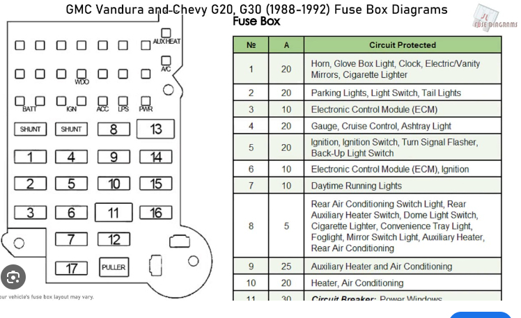

Can I get a list of fuses for interior box?
1983 CHEVROLET VAN
61,000 MILES • 5.7L • V8 • 2WD • AUTOMATIC
AZDANNO04
  • 343 POSTS
Everything is covered in dust and cobwebs.
Jul 20, 2024 at 9:54 AM
This is the only information I can find on the fuses and check out the image below.
Heater-A/C - 25 Amps
Stop/Haz - 20 Amps
Gauges - 10 Amps
Ignition - 10 Amps
Cigarette Lighter - 20 Amps
Taillights - 20 Amps
Radio - 10 Amps
Backup Lights - 10 Amps
Dome Light - 20 Amps
Horn - 20 Amps
Power Windows (if equipped) - 30 Amps
Power Door Locks (if equipped) - 20 Amps
