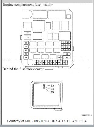

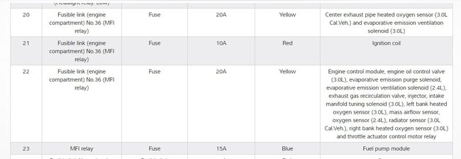

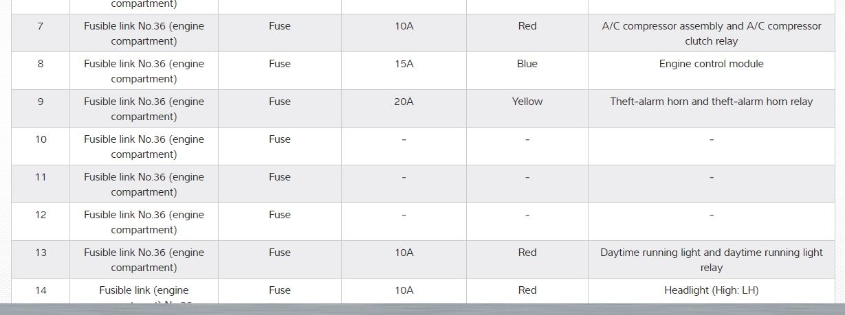

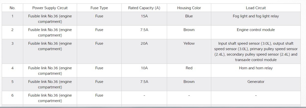

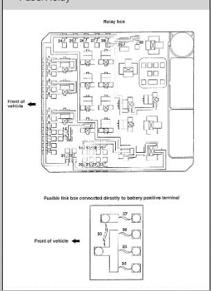

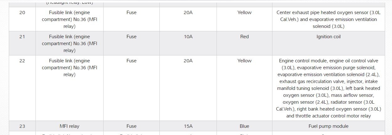

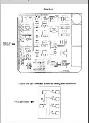

It sounds like you have lost one or more of the voltage feeds to the engine control module, I have attached diagrams showing the three different circuits that should be checked and a link to our tutorial on testing wiring. If any of these have lost voltage there would be no communication with the scanner.
Please note that fuses 2, 8 and 22 supply the engine control module. I hope this is helpful and if you need any further assistance we will be happy to help in any way we can and thank you for using 2CarPros.
