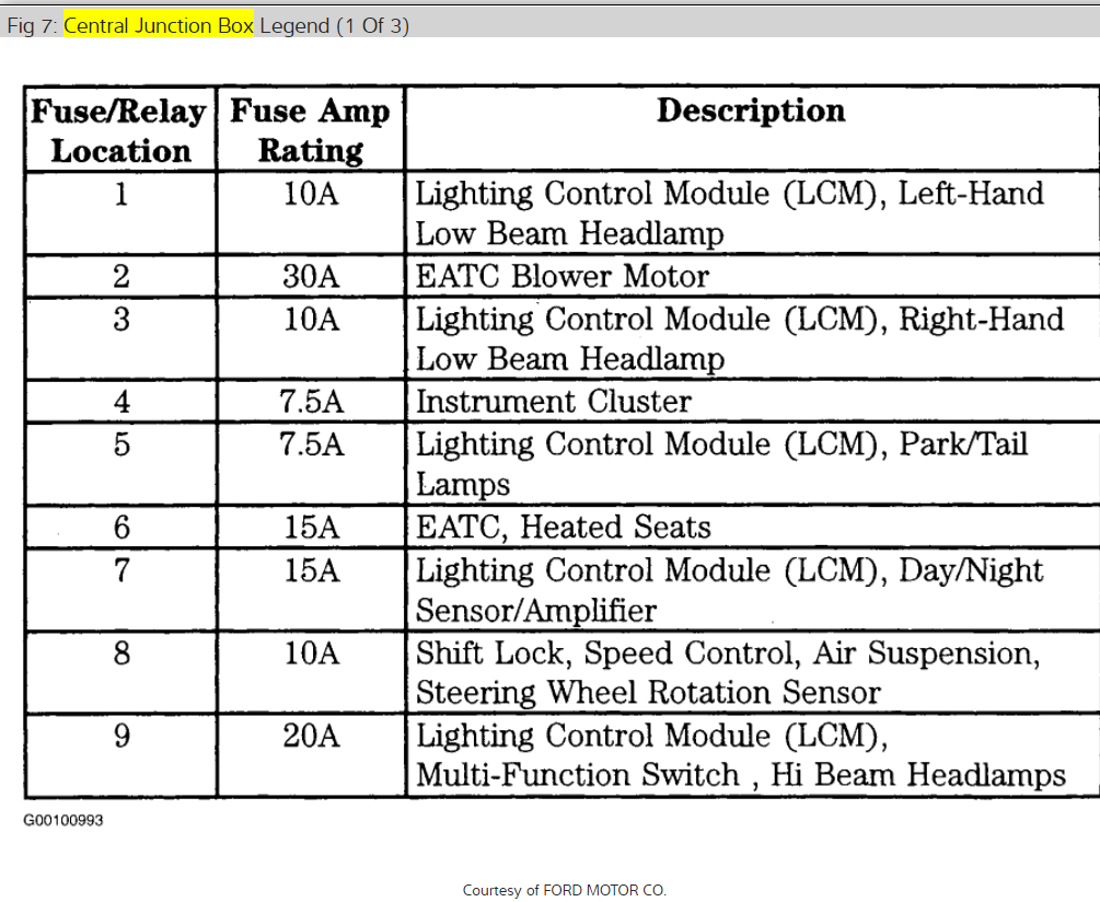

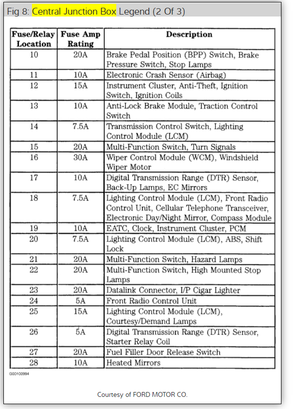

Need fuse box diagram 99 lincoln town car please
thanks
Mar 3, 2010 at 4:51 PM
BLUELIGHTNIN6
  • 16,542 POSTS

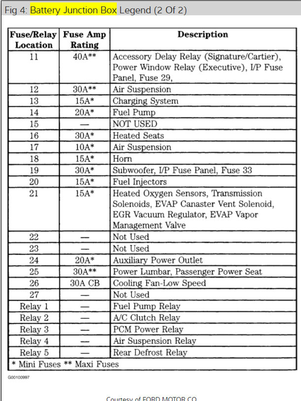

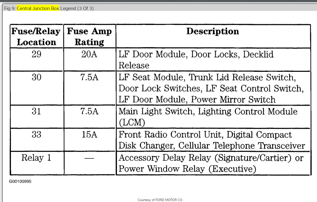

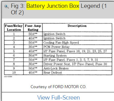

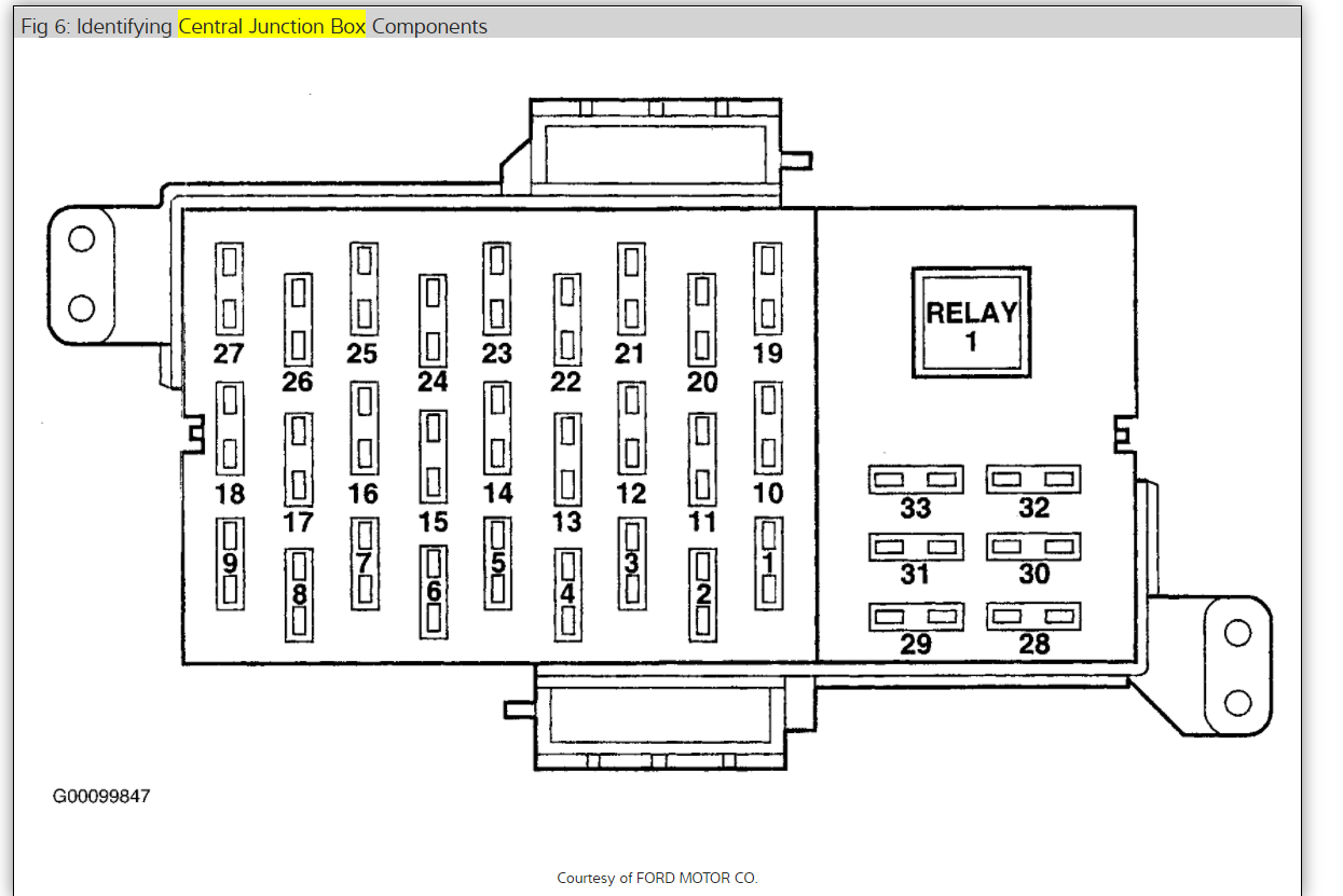

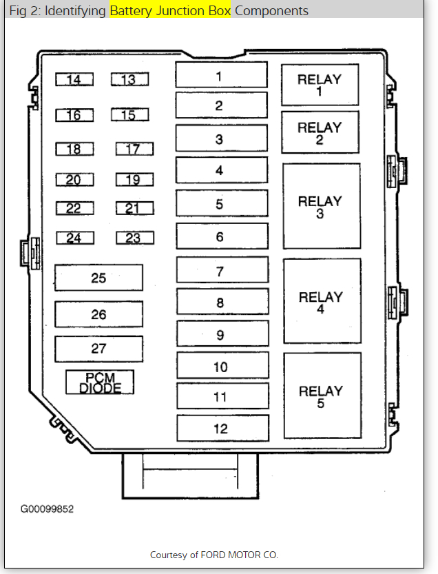

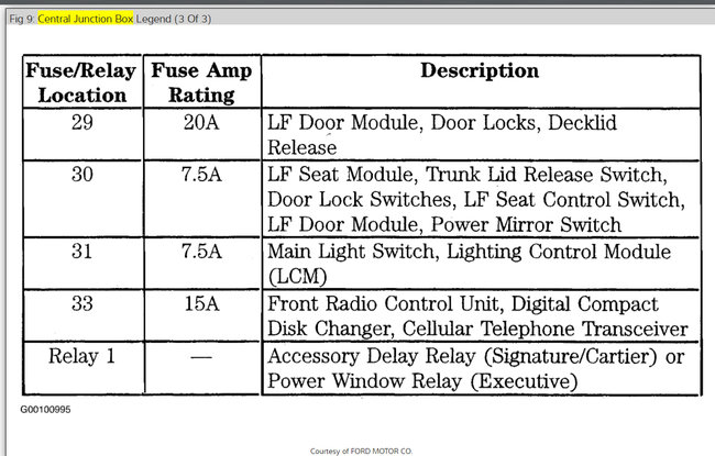

Here are the fuse panel diagrams below and a guide to help you check for power at the fuses.
Cheers, - 24

mileage is estimated. Its my friends car. He asked me to help him locate the air suspension problem. Since i don't have the diagram, i need help. Also, he says he changed the airbags (suspension) 18 months ago. I cant tell if the pump is working, and the fault light isn't on for that system. The switch looks like it works and i managed to download a step by step trouble shooting for the system. Just need the diagram. Can U help?
Oct 30, 2018 at 1:58 PM (Merged)
BLUELIGHTNIN6
  • 16,542 POSTS
here is the electronic suspension system components and locations. is that what you need?
