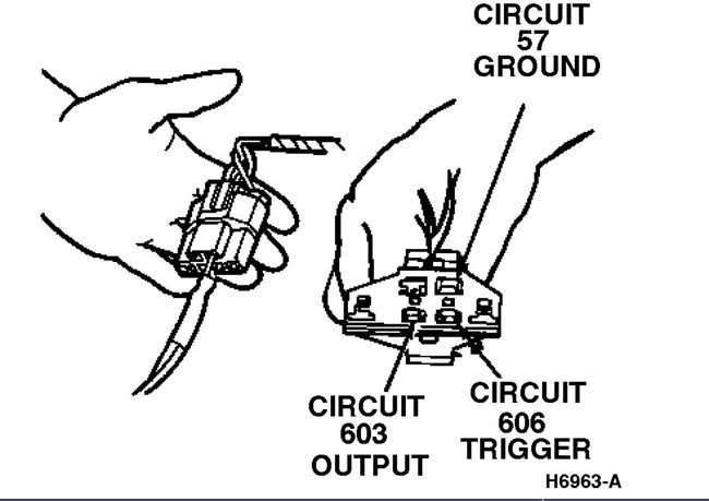

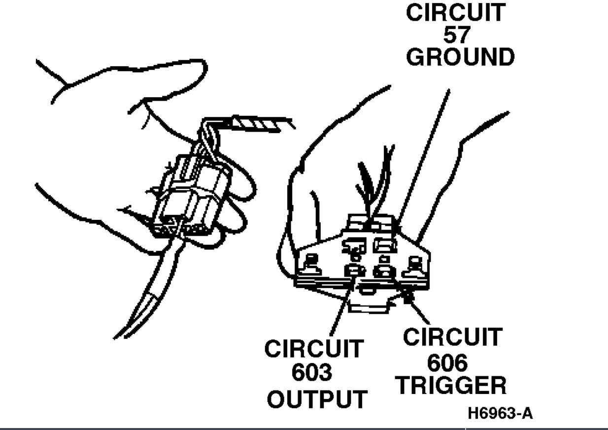

Picture of the diagnostic connector is attached below
