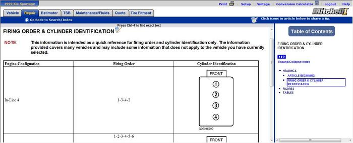

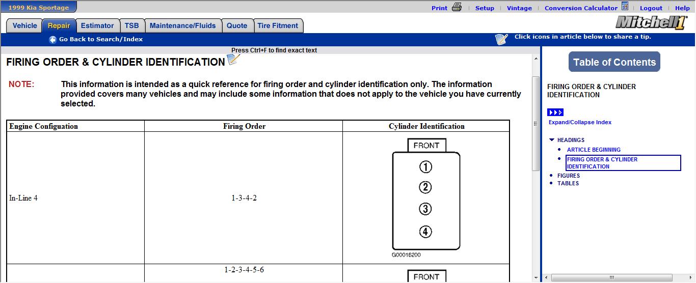

I would double check to make sure you have the correct cylinder and then recheck the compression and each of the component you have replaced. It sound like you may have got a defective ignition coil.
