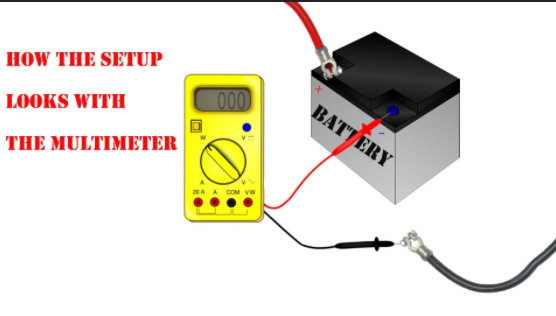

However, if we want to test the system, we need to hook the meter in series with the negative battery and then see what the amperage is when the vehicle is completely off. Then we need to remove the fuses until the draw drops below 35 milliamps (.035 amps).
Please see the diagram below on how to set this up.
Let us know what you find. Thanks
