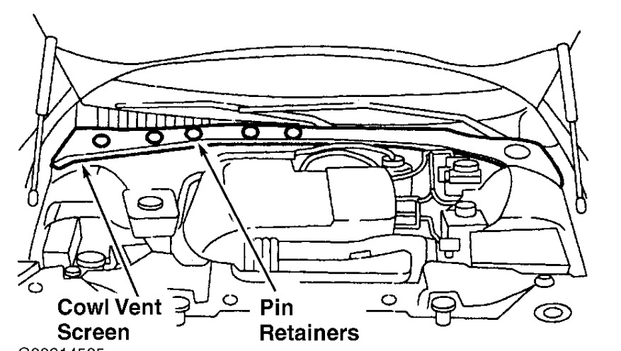

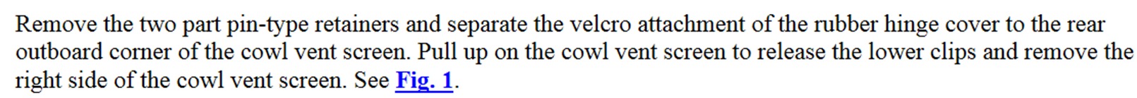

it's under cowl, have to remove the cowl side trim pieces, then remove the wiper pivot arms. remove the cowl vent screen retainer and disengage retaining clips and position cowl vent screen aside.

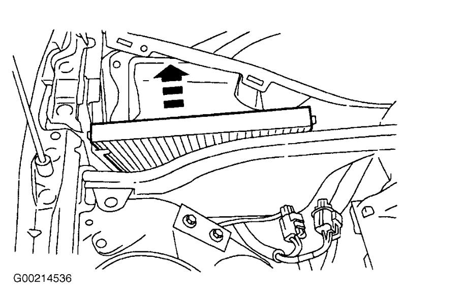

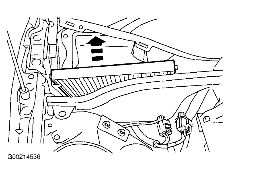

see pic also to reset Tap the reset button dont hold the first time or it will continue to scroll. Check out the diagrams (Below). Please let us know if you need anything else to get the problem fixed.

it is under the hood on the passenger side at the fire wall you need to take out the plastic retaining srcews and pull off the plastic cover
