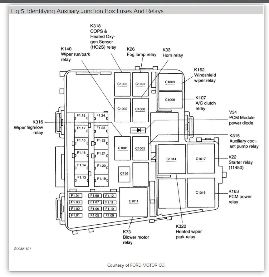

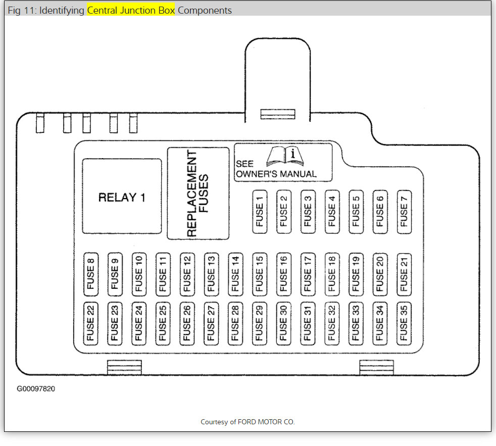

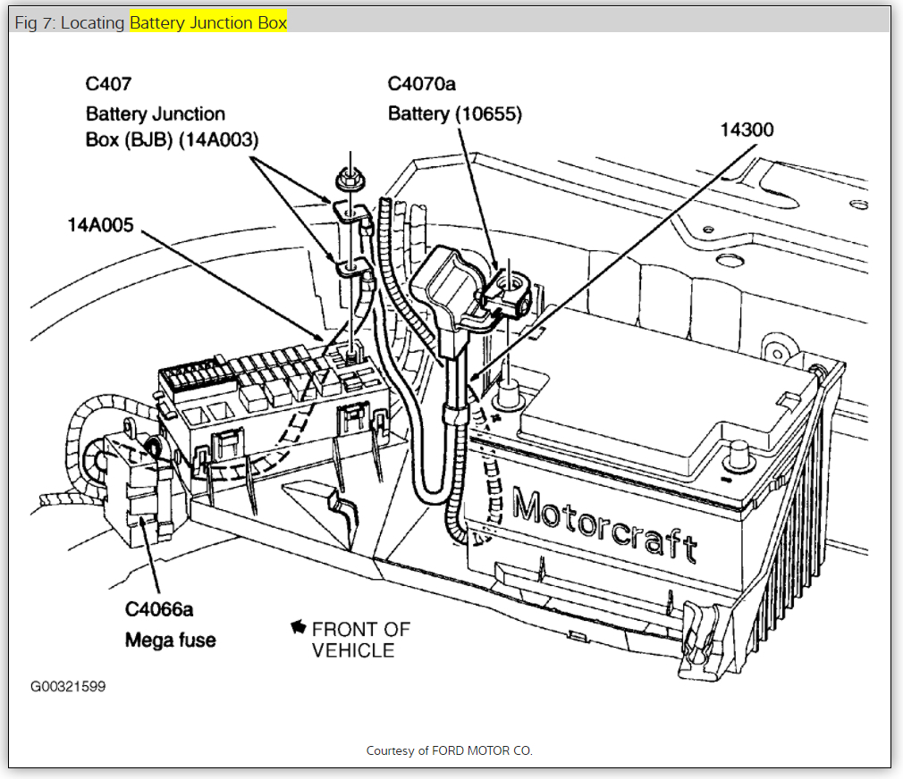

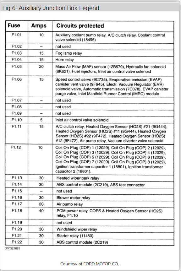

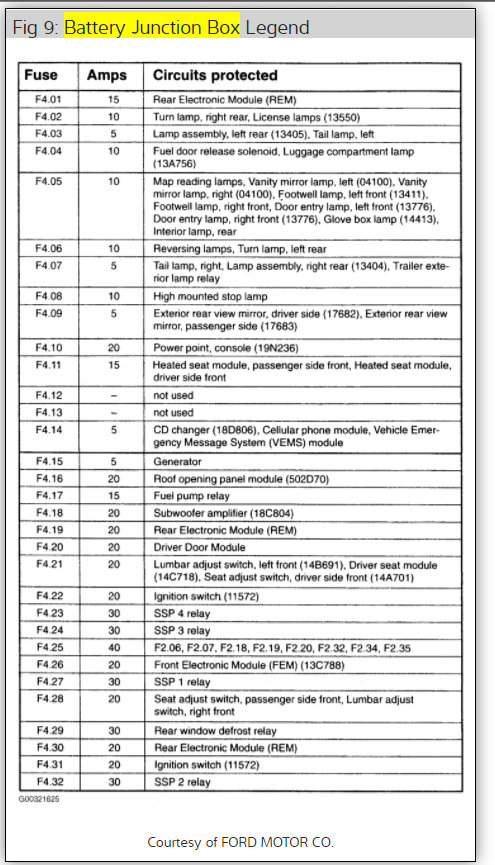

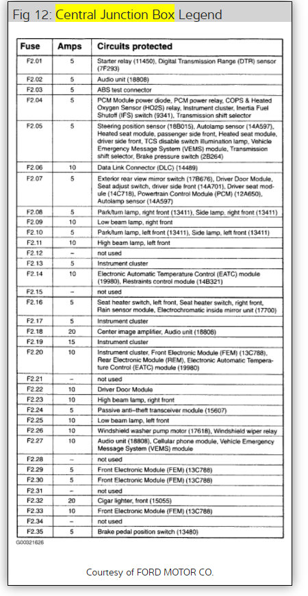

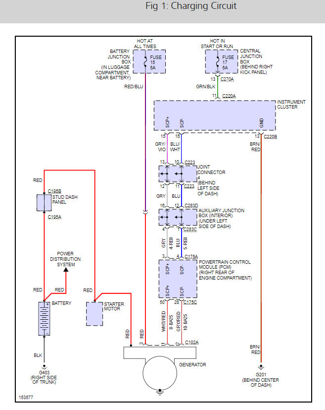

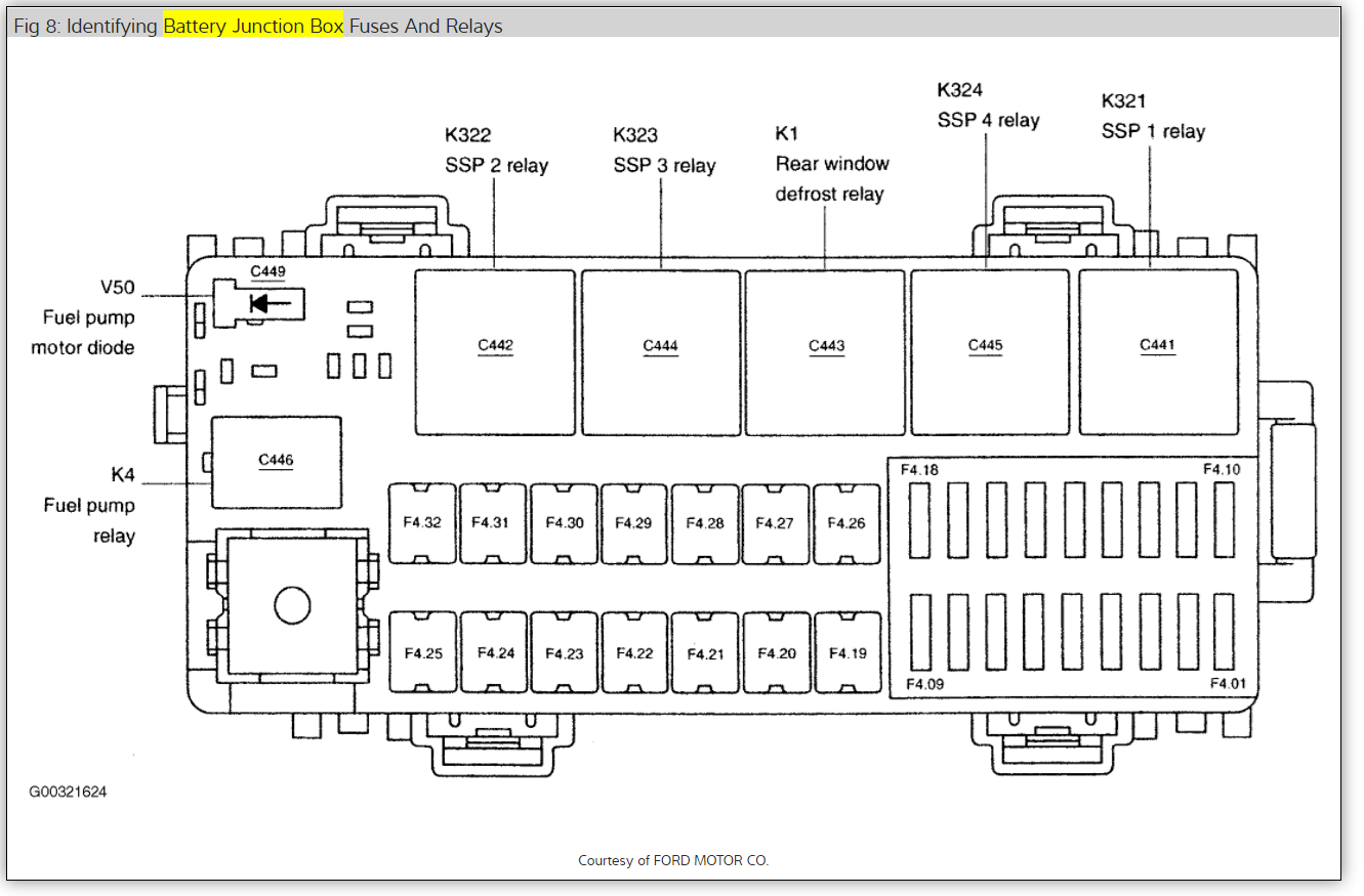

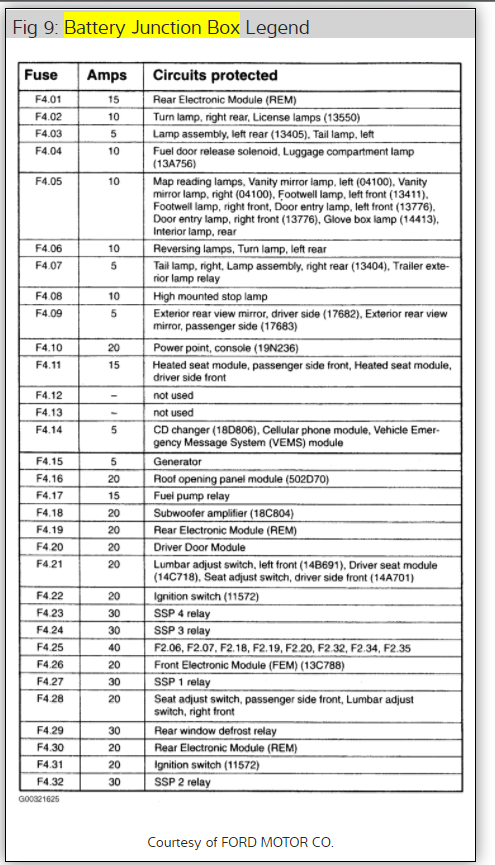

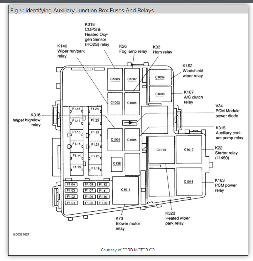

Here is a alternator wiring diagram and fuse location along with a guide to help us do your own testing. I am thinking the problem was a loose fuse connection which causes heat and damage. Just repair the damage and you should be fine.
