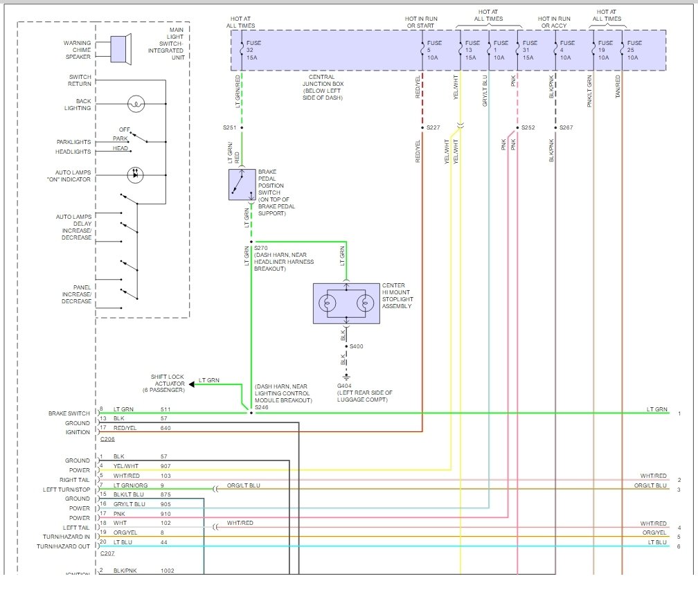

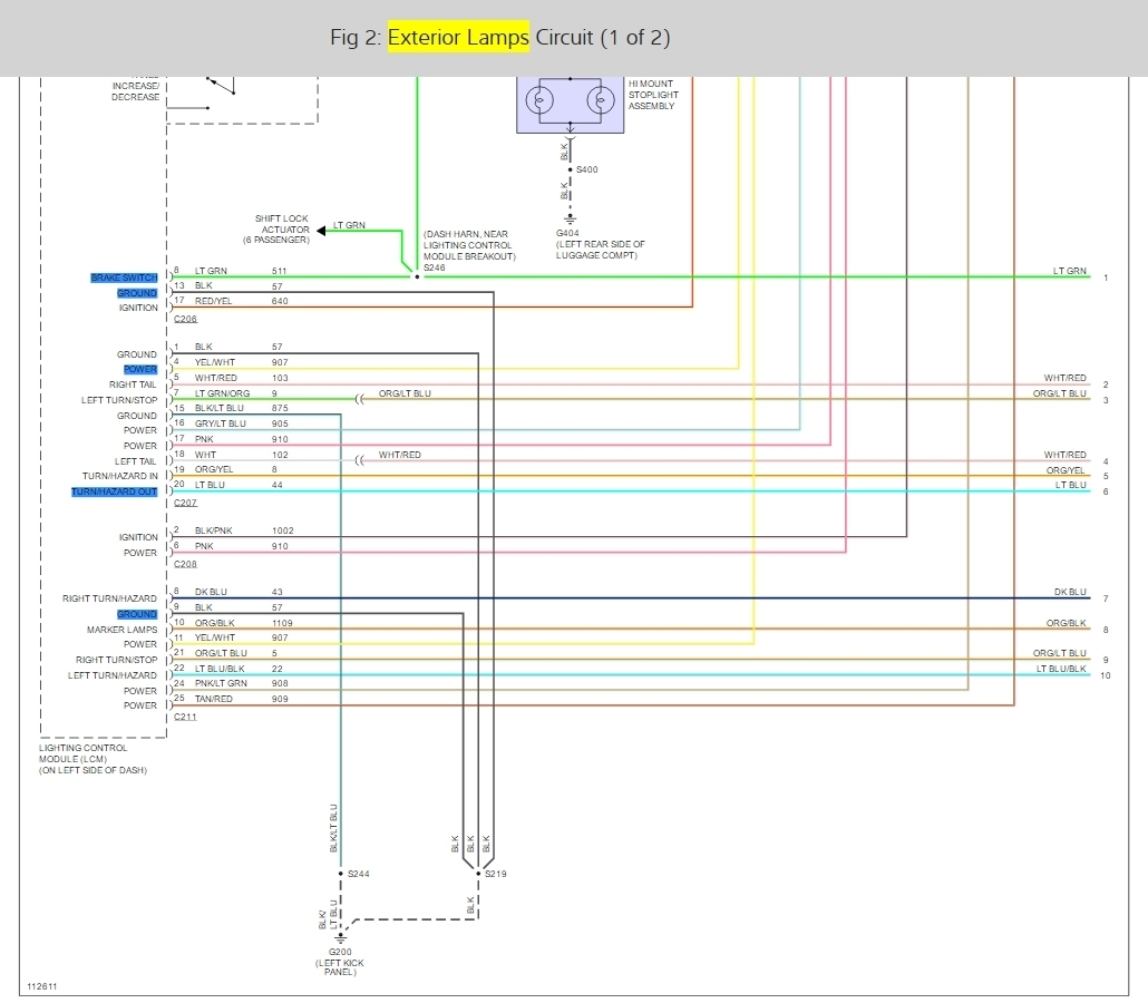

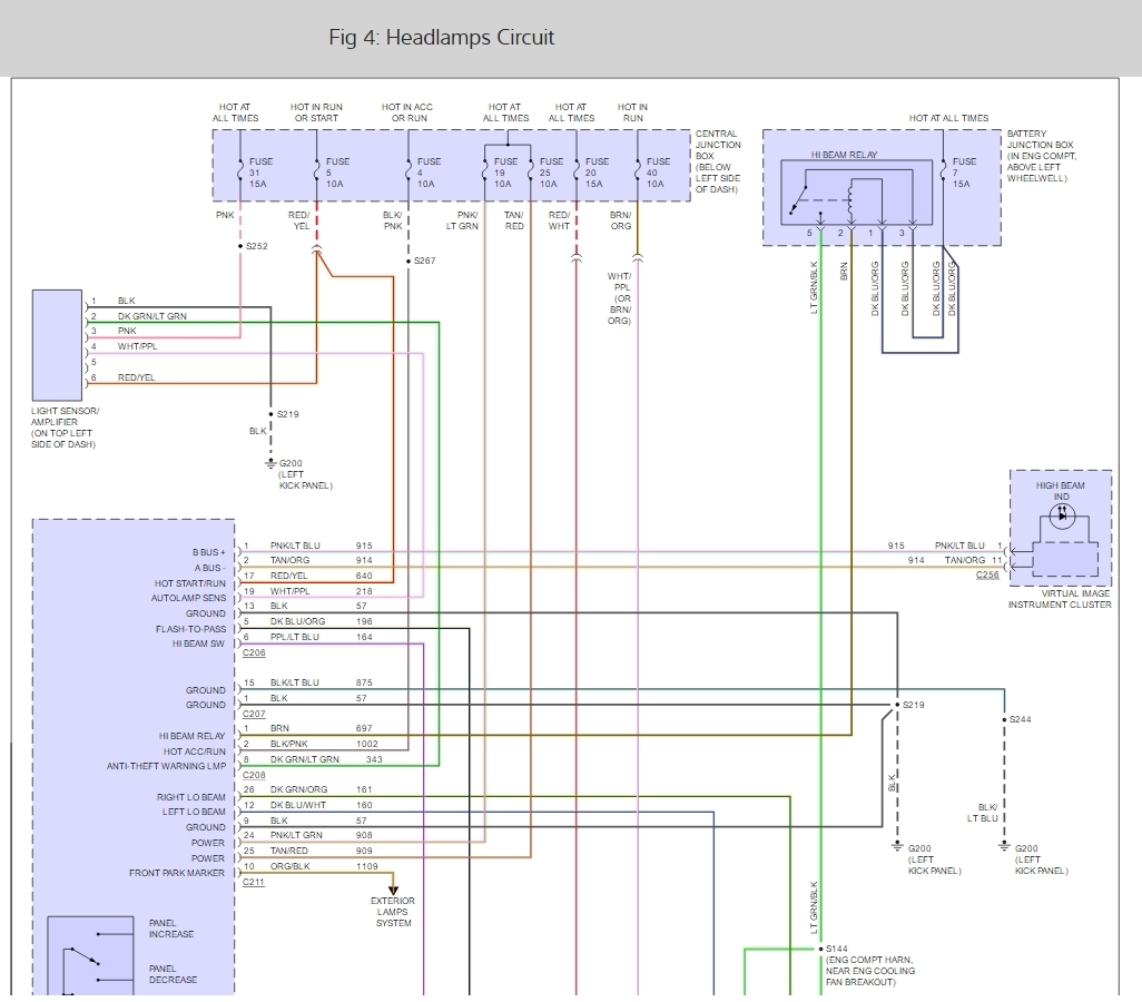

Hey Ag6800,

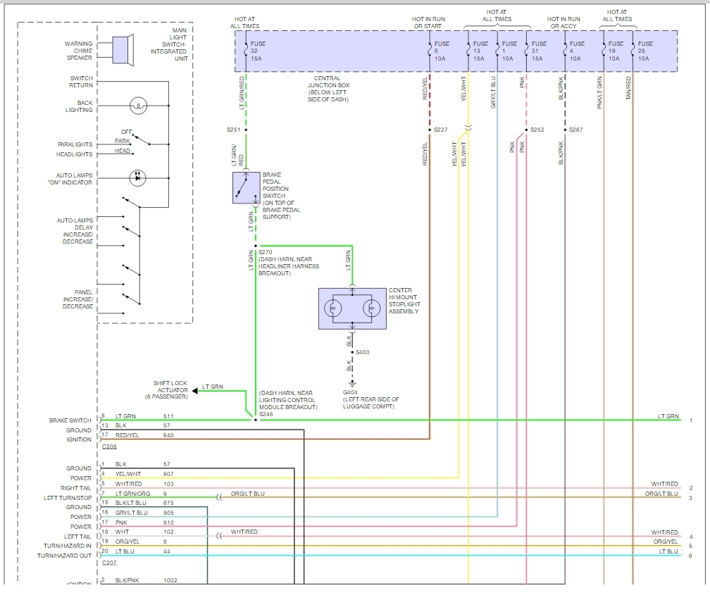

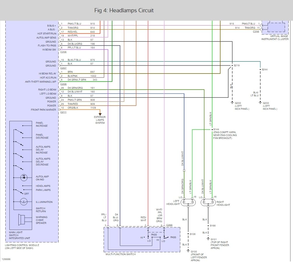

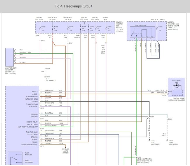

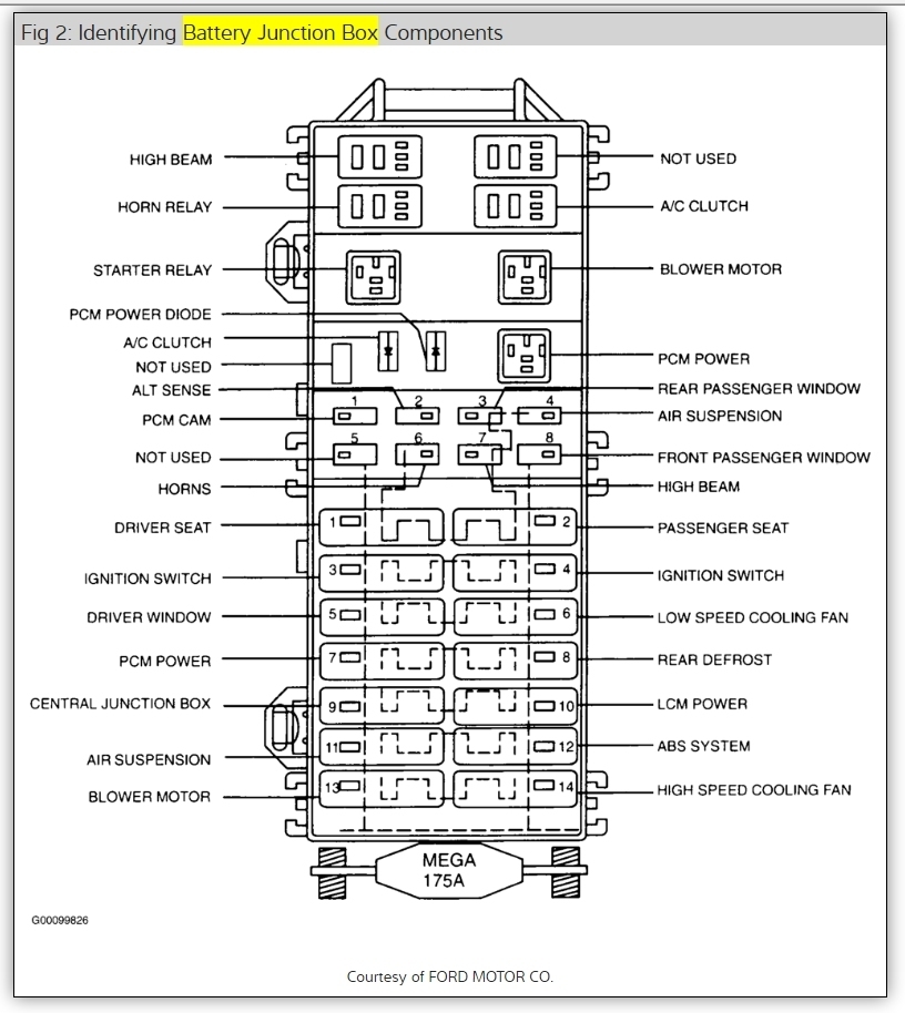

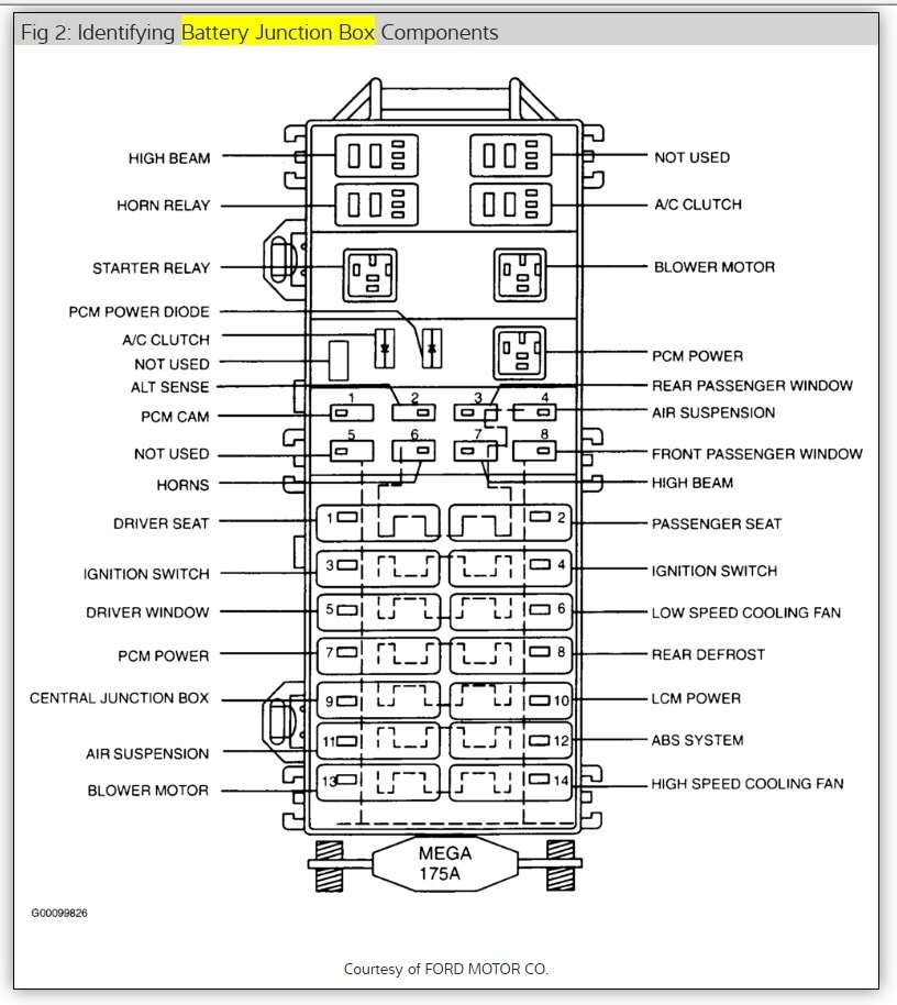

It sounds like the fuse has gone out but you should check the bulbs themselves becasue they have a separate filament for the high beams. Here is a wiring diagram and fuse locations to help you find the problem.
Also there is a lighting control module that might be bad, check all of the fuses listed below in the diagram.
Here is a guide on how to check the fuse.
Please let us know happens so it will help others.
Best, Ken
