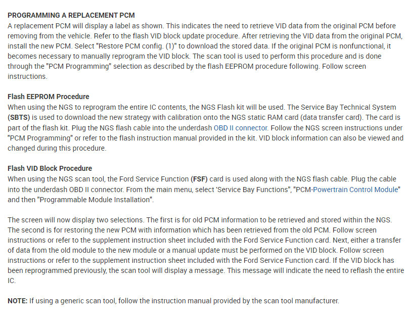

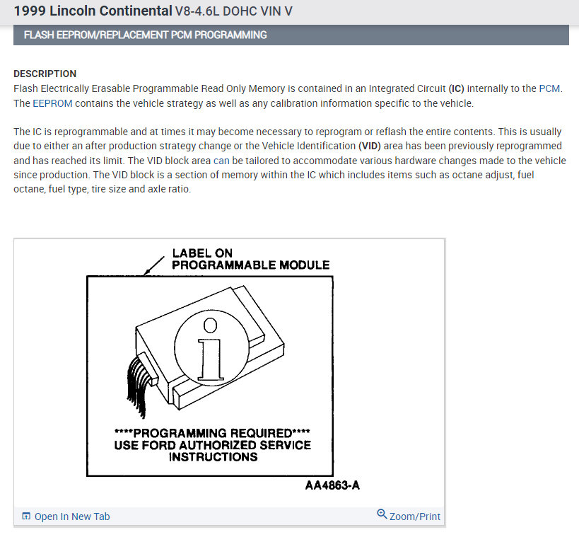

Yes, the replacement PCM must be programmed to the vehicle, otherwise it will not be recognised by the vehicle.
Programming a PCM requires specialized programming tool.
See attached guidelines for PCM re-programming.
