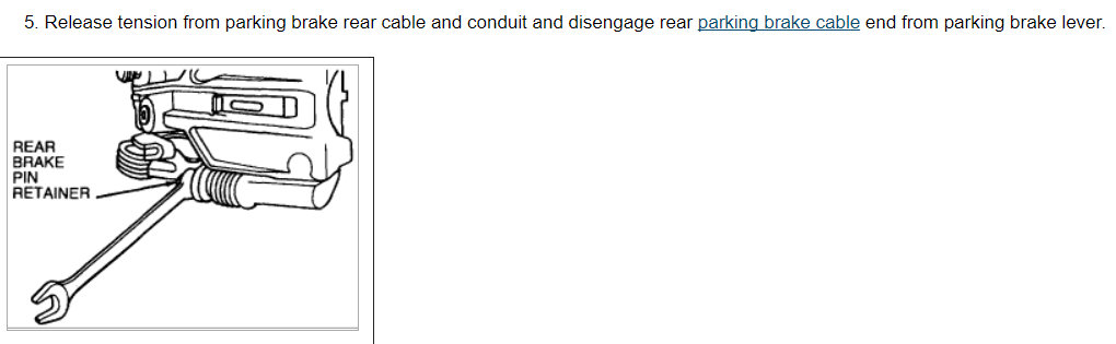

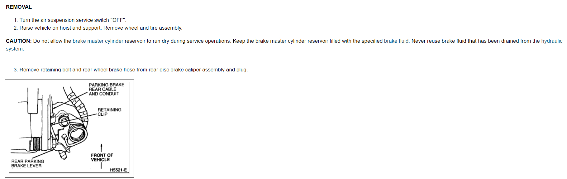

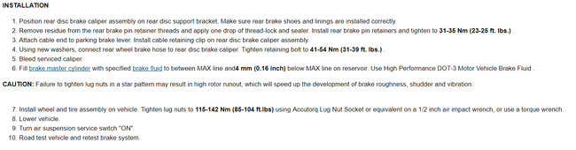

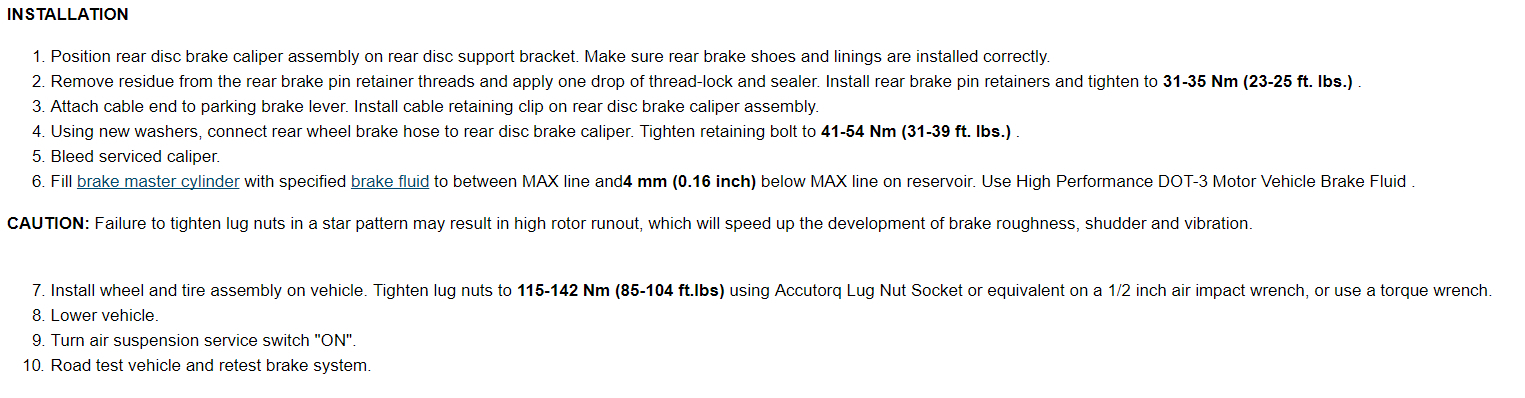

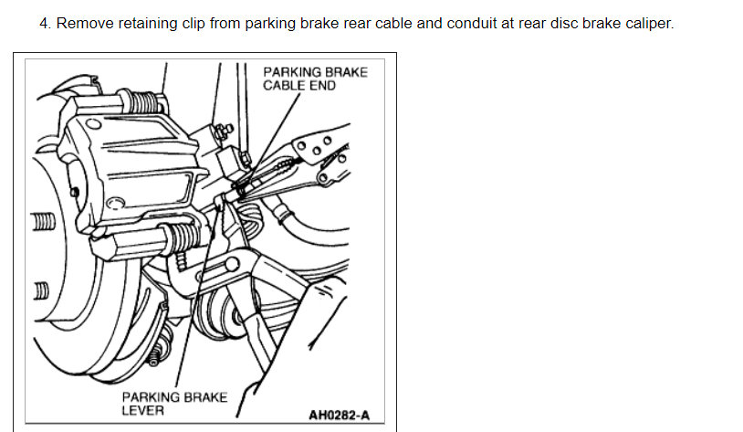

You may need to remove the brake line or gently bend it out of the way. Here is a guide that will help you with the job.
https://www.2carpros.com/articles/how-to-replace-rear-brake-pads-and-rotors
You will need to jack the car up
Here are diagrams that will help you get the job done on your car (below)
