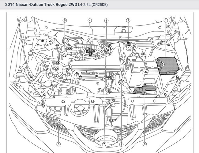

This is common when the throttle body needs service. here is a guide to help show you what to do with instructions in the diagrams below to show you how on your specific car. Please go over the guide before you begin.
#3 is the location of the throttle body. Check out the images (below). Please let us know what happens.
