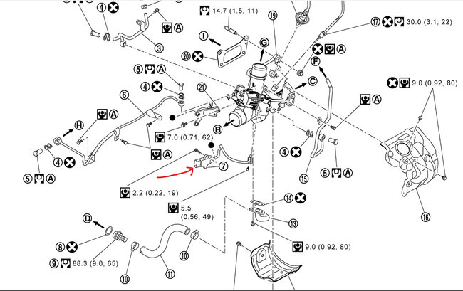

Yes, the sensor can be replaced, here is the location, it will be on the left side of the engine. Check out the images (below).
Image (Click to enlarge)

Puts it into limp mode. Delete and drive for a while then comes back. Where is this sensor?
