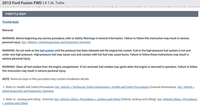

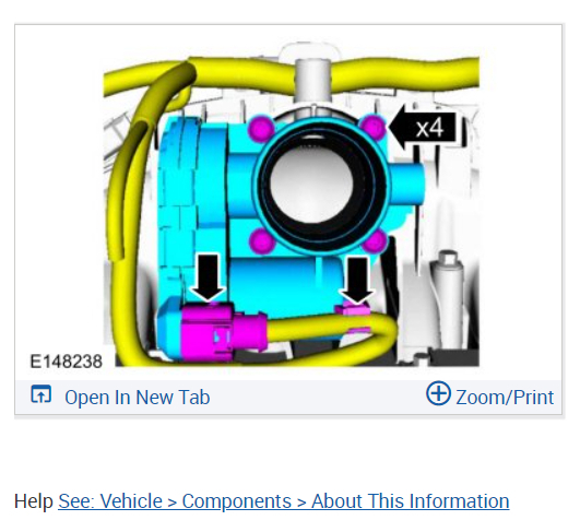

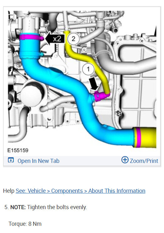

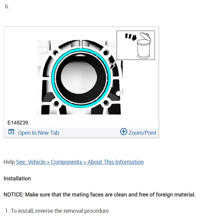

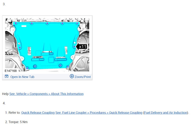

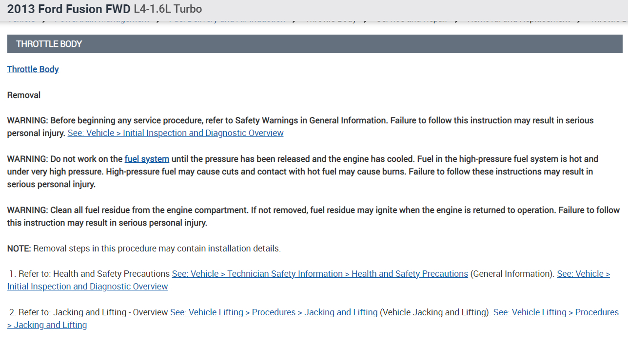

This guide may help us find out. If there are no codes, I would service the throttle actuator.
Here are guides to help and how to service the throttle actuator on your car in the images below:
https://www.2carpros.com/articles/reduced-power-limp-mode
and
Check out the images (below). Let us know how it goes.
