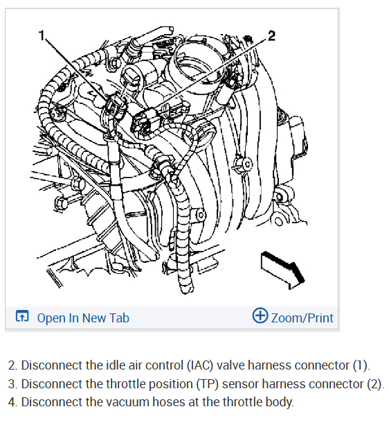

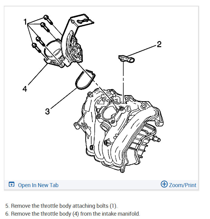

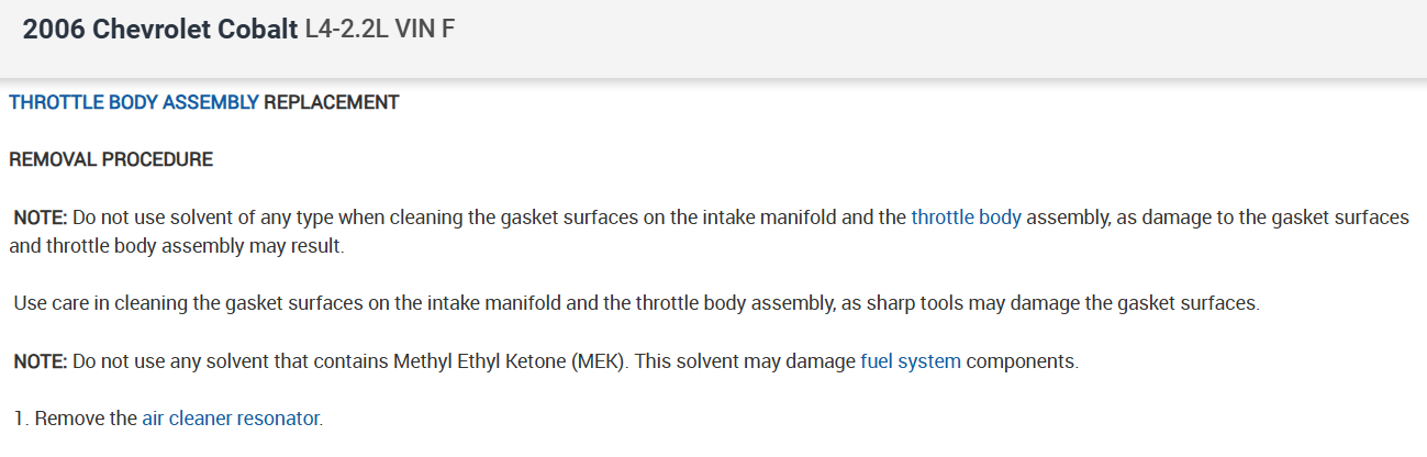

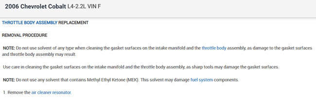

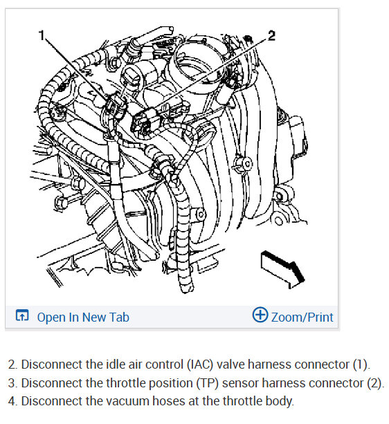

Did all of these codes come up at once? If so, you may have a bad PCM, but the code that stands out for limp mode is the throttle body.
P2101 - Throttle Actuator Control (TAC) Motor Circuit Range/Performance
I would try cleaning the throttle body first by following this guide:
One the job is done clear all cods and take it for a drive to see what happens. Here is how the job is done on your car. Check out the images (below). Please let us know what happens.
