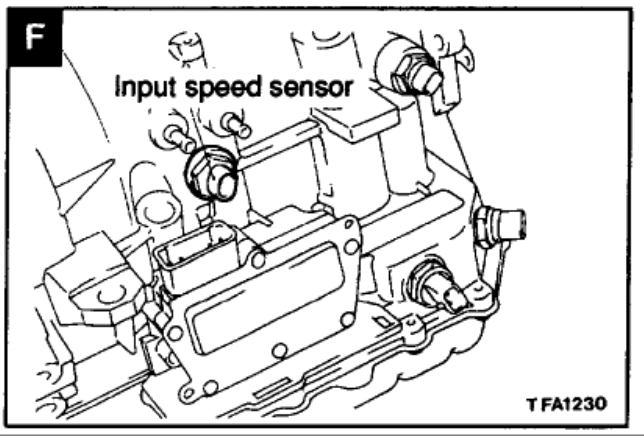

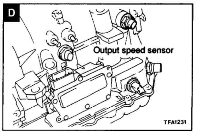

Yes, you would be right the turbine speed sensor is where I would start. Here is its location.
Here is a video of one getting installed and the location for your car below:
https://youtu.be/f3bETtCIdxM
I gave you both sensor location so you do not get them mixed up.
Jun 7, 2018 at 8:10 PM
