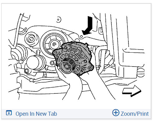

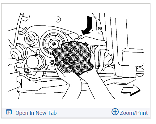

15.Remove alternator mounting bolt (lower) and alternator mounting nut (lower).
16.Remove alternator from the right side of the vehicle.
CAUTION:
Be careful not to contact with and damage surrounding parts when removing alternator from the vehicle.

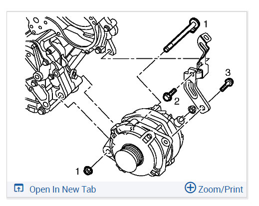

INSTALLATION
Note the following items, and then install in the reverse order of removal.
CAUTION:
- Temporarily tighten all of alternator bolts and nut. And then tighten them in numerical order shown in the figure.
- Install alternator, and check tension of belt. See: Drive Belt > Procedures > Checking Drive Belt.
- Be careful to tighten "B" terminal nut carefully.
- For this model, the power generation voltage variable control system that controls the power generation voltage of the alternator has been adopted. Therefore, the power generation voltage variable control system operation inspection should be performed after replacing the alternator, and then make sure that the system operates normally. See: Charging System > Initial Inspection and Diagnostic Overview > Inspection Procedure.
