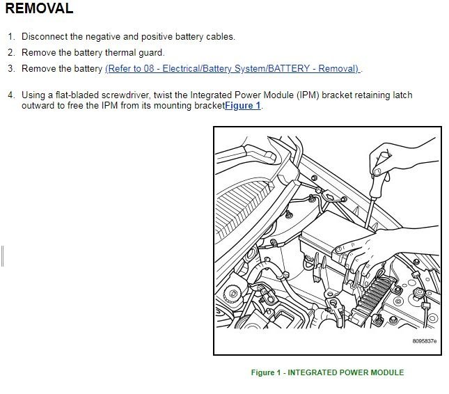

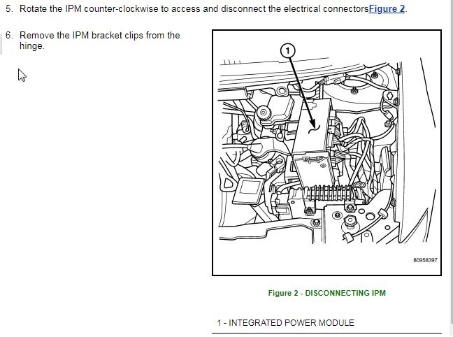

I went ahead and paid for a diagnostics test and the mechanic said it was my power module not communicating and it would need to be replaced. He gave me a quote of $848.00 for the repair. I am not able to even find anywhere that sells a power module, so I am not sure what exactly needs to be replaced. I would prefer to just buy the part and install it myself if I can.
Jun 20, 2019 at 9:23 AM
Okay. I assume they are talking about the Integrated Power Module. This is basically the main power distribution box. I included the procedure to remove this.
This makes sense as to what happened, but I would just make sure they found some evidence that this was the issue rather then them saying it is the likely cause. As you can see, it is a costly part that we want to make sure that this will fix it.
Let me know if you need anything else. Thanks

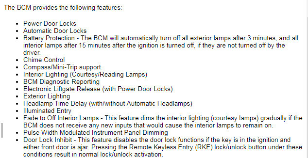

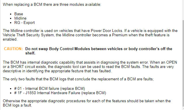

Unfortunately, it still could be the BCM. However, as I said before, unless they are giving you a reason it is the BCM like they have a code or did some diag it appears it is just a guess and that is why they said you should take it to a dealer.
Please see the attached document from the manual where is says not to swap BCMs with other vehicles.
At this point, I imagine you have spent more than $125.00 since the IPM was not cheap. Even if it takes them a couple hours to figure it out, it may be better than letting this other shop continue to guess at it, which is what it appears they are doing. If they just diagnose it, you may be able to do repair yourself but having someone with a scan tool able to evaluate this is what is needed.
The BCM controls the items listed in the second attachment. It appears to fit except for the ABS and brake light, or the AC system not working as you said do not fit but I would not get a new one until you have it checked out.
