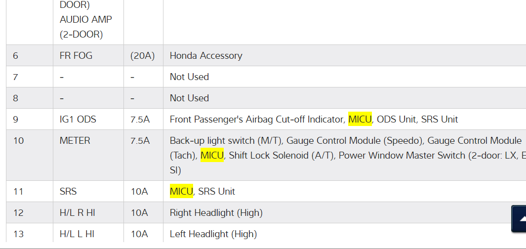

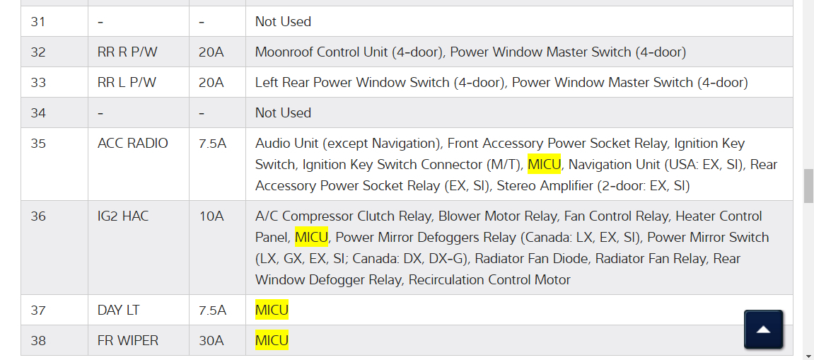

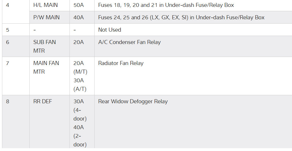

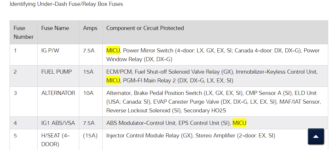

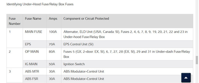

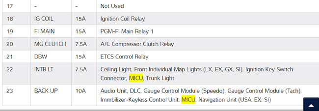

This does not happen constantly but while I'm driving at night I have noticed that the headlights will start flickering really bad and no matter what I do they wont stop. Then after awhile they suddenly stop. Could this be an electrical short? If so, would it just be the wiring for the headlights or the whole electrical system? How would I go about self diagnosing this problem?
